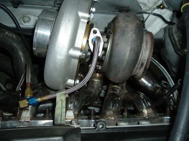

i didn't have clearance issues at all with mine, i just shoved it back in it's hole and made a little alloy bracket and bolted it to the compressor housing :)
here's a pic, you can't see it too well but it is there

it will fit... all you have to do is rotate it so that it is in between 5 and 6 cylinders and weld a small tab to secure it
