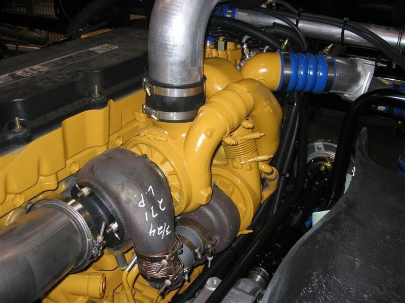

That series turbo setup comes factory on a lot of the newer CAT diesels. On the motorhomes I work on, they have problems keeping the charge air cooler couplers on. The fix is to install a second t-bolt spring clamp to all connections. They run up to 50psi from the factory.

Tsuper, you bastard! nice compound setup. i notice its an Aurora setup, very nice! that turbo on the manifold is a stocker or at least a holset isnt it? is it an HX or a later HY or what? the secondary turbo looks something like a 4088 or something.
