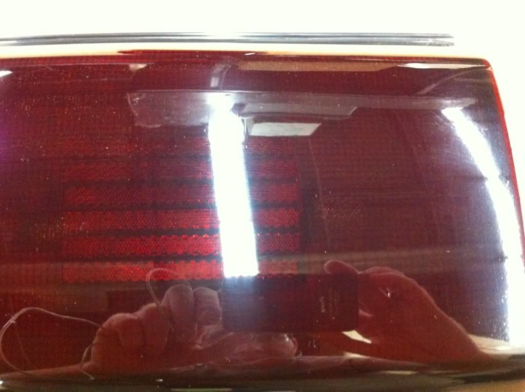

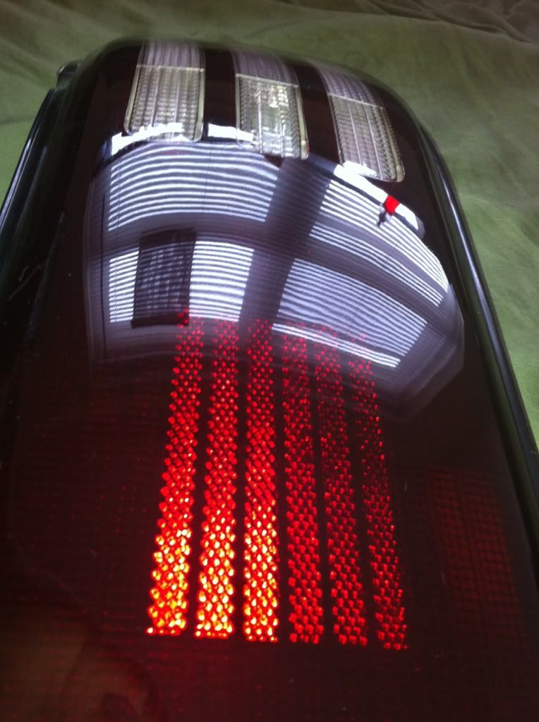

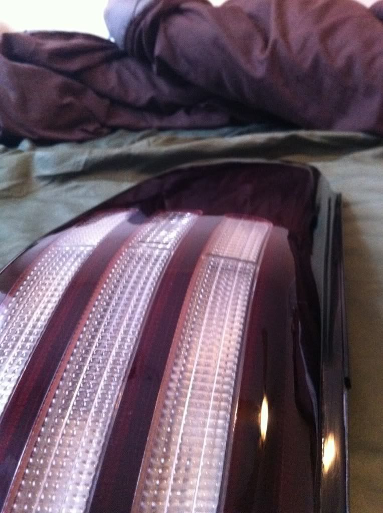

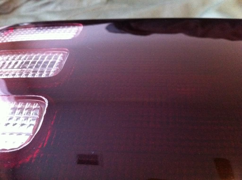

did some work on a friends 3pc tails....was rather proud of the outcome.
gaboonviper85
Jan 13, 2008
3,236
Northeast Philly
started out sanding with 600 grit to get the years of wear out....then buffed to help find stuff i missed...left one was done
then taped them out after ruffing them up with 1500 grit paper
3 coats of vht night shade and them removed the tape
then maybe 7 coats of clear and sanding with 2000 grit paper plus compound "meguiars ultimate compound"
did all this at work while my machine was running....took about two days in total as i couldnt work on them non stop.

Hell, they looked amazing before the tint. I would have just made it more blood red than black though.
They look darker than they really are because bad lighting...they do look blood red.
This is up close
