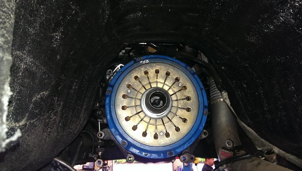

FYI: you're installing the clutch the hard way (and it's likely to bend the pressure plate). PP is bolted to the flywheel after tranny is installed for a reason.

I know. Nice catch. I just mocked it up for the pick. I left it like that over the weekend at work and didn't want to lose any bolts so I hand tightened them all in.

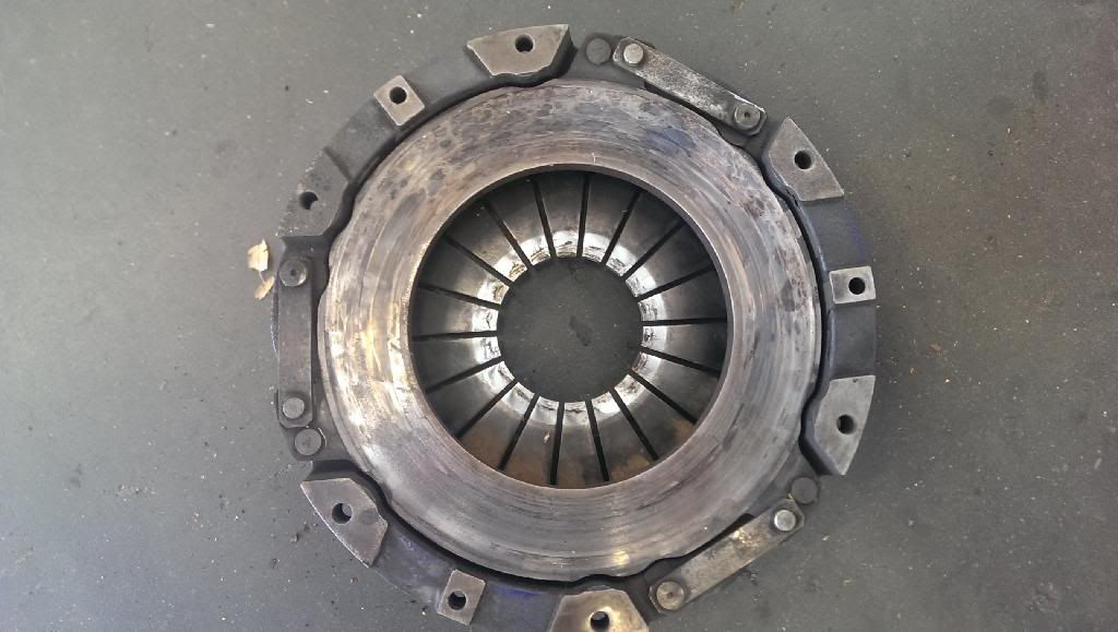

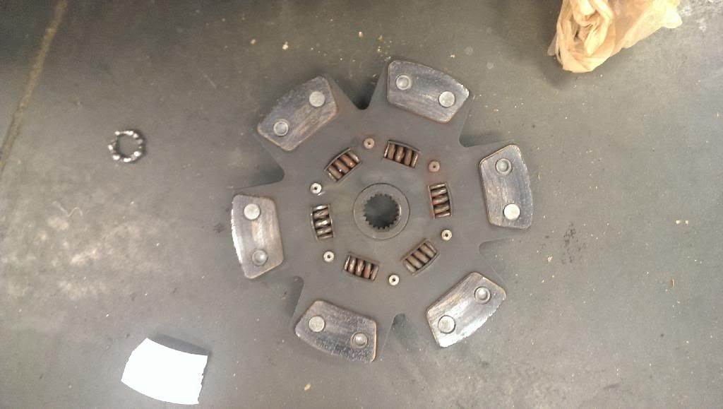

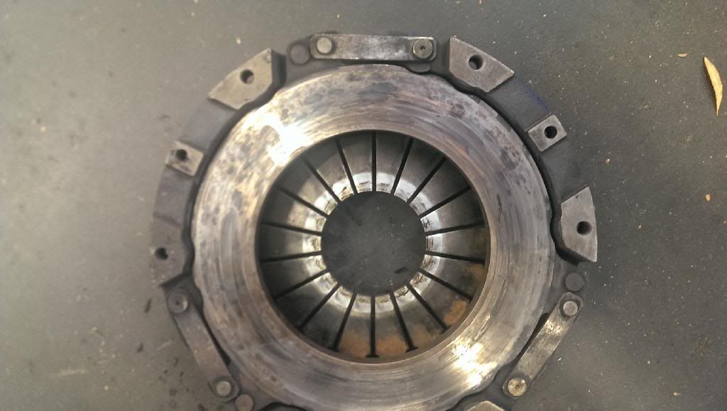

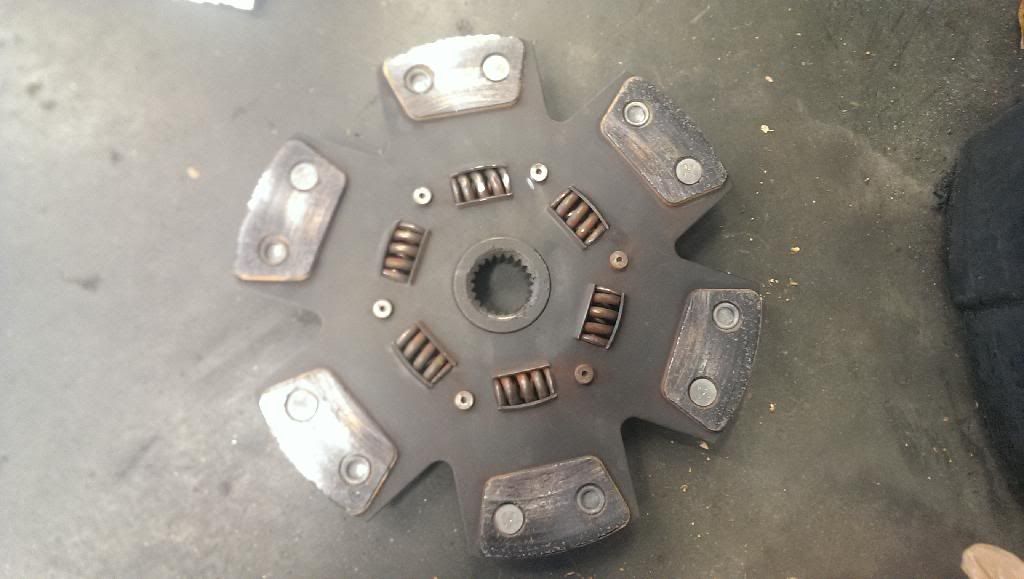

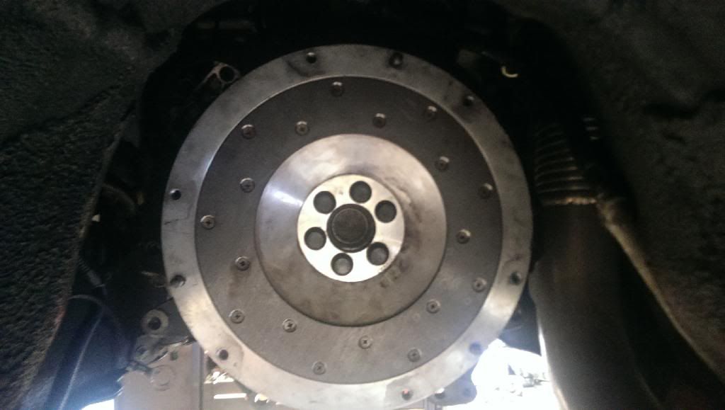

Pedal pressure is crazy heavy because you put a crazy heavy pressure plate in it... Those flywheels are known to fuse.
MarkIII4Me
Project OVERKILL!!!
Apr 10, 2005
1,250
Charleston, SC
I knew it's a heavy pp when I decided to go with it. Never heard of a factory Aisin disk fusing to the flywheel. Weird thing is the pedal feel has gotten heavier with break-in. I would think that the opposite would be true, or no change at all.
