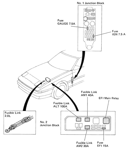

Where exactly is the fusable link between the headlight and fusebox? I have it all apart and I can't seem to find it.

It attaches to the positive terminal and is likely covered with black heat shrink. Follow the wire from the positive terminal that connects to a white wire under the fuse box. That one is it.
edit: white not white/black
