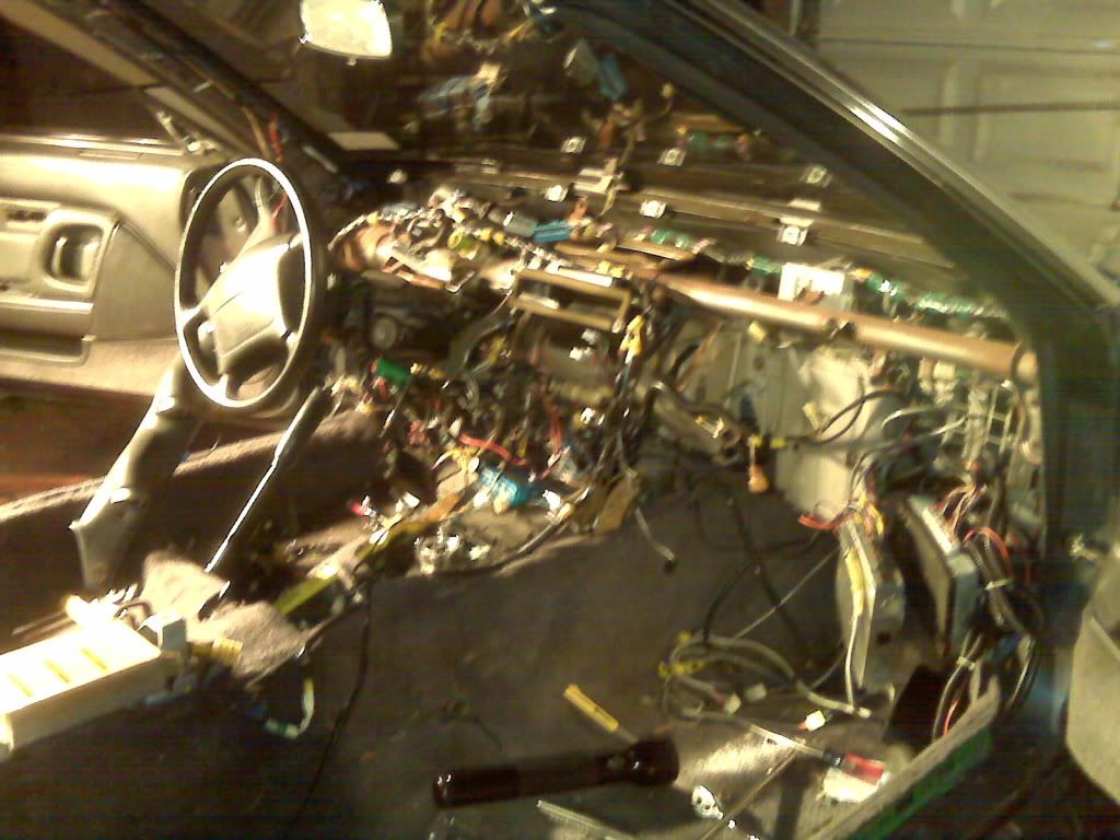

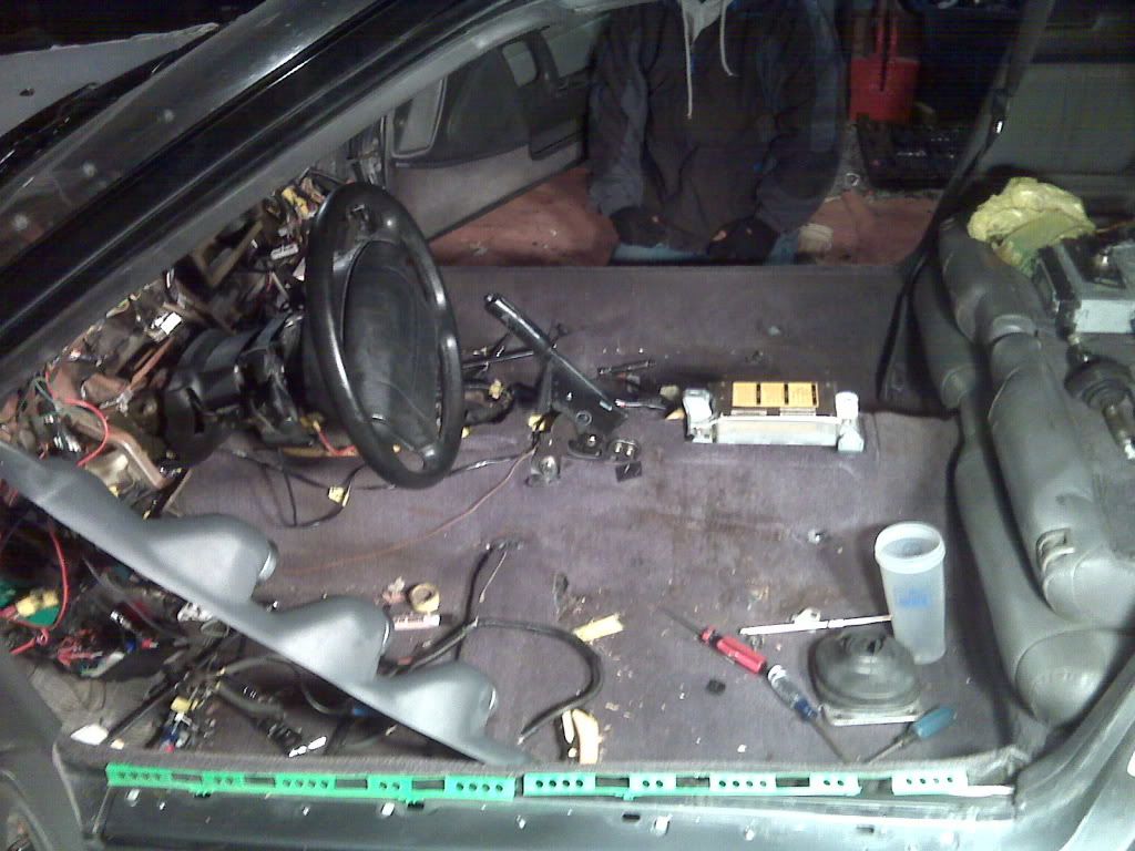

I agree with you Figgie 100%. What a huge PITA. That was the toughest part of removing the dash for me. I had to somehow get my head underneather the damn steering wheel and fit my hands through a tiny hole. God that sucked!
Here's a couple pics. I pulled mine last Saturday.
-Mo

EDIT: oh boy that picture made me a little scared
