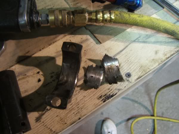

funky_monkey58;1446236 said:
I see nothing demeaning in that post.
I know too well how common "rebuilt" engines are.
Remember when I posted this.
lasted me less than 50 miles "rebuilt 7mgte"
I lost faith in peoples word after that when it comes to rebuilt engines.
At the very least I would pull the engine apart and plastigauge everything and check ring gaps.
Nothing wrong with bringing attention to a potential issue, if I would have taken the time to disassemble my engine completely it would have saved me several thousand dollars.
When it started making noise you didn't stop?
