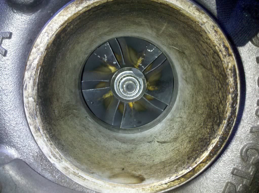

supposedly the turbo I got is a .60 trim.... I had a look at it and am guessing not haha

Thanks for the link.. more to look at.. I was wondering I know the bigger you upgrade the ct26 the more lag there is.. most say use the .57 trim ct26 doing some research ive come up with the folowing specs.
* 46 Trim: 41lb/min or 410hp * 50 Trim: 47lb/min or 470hp * 57 Trim: 49lb/min or 490hp *60-1: 61lb/min or 610hp
Wouldnt using a 46 trim yield the best boost response while allowing me to make the power I want with headroom? Cant seem to find out but what is the stock ct26 trim?

I thought stock was 46trim. you can go 54 trim, but honestly, a .57 trim is a great turbo, and almost everyone loves it to death :cool:.

Ok thanks Jeff, just trying to learn as much as possible... read just read that the stock is 46 trim but alot of people objected saying its not "technically" and whatnot.. it does seem the 57 is the way to go, proven to make the power I want and the dyno charts ive been looking at do look nice.... the difference in lag cant be more than a few hundred rpm between the 46 and a 57....can it?? Did you get the email I sent you?
