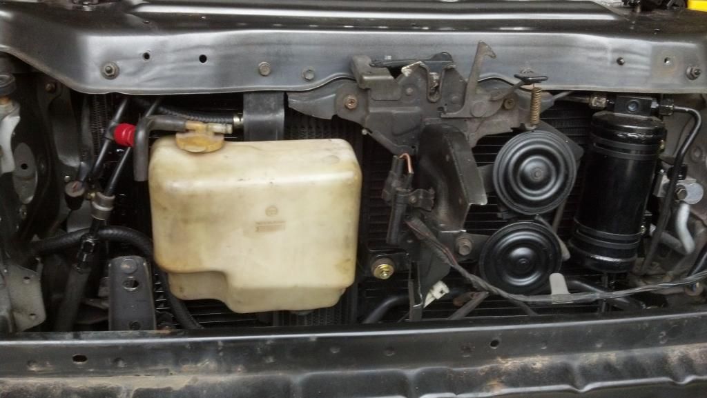

The first thing I did was go to the hardware store and pic up a 1" by 3' 1/16 piece of steel for the top mounting brackets. I picked 1/16 thick so it would bend easy. I also picked up a 2" by 3' 1/8 for the bottom ones, you don't need that much but I think I spent like $8 on all of it. Next thing I did was remove the stock intercooler, hood latch and the bracket that stiffens it up, oil cooler, and overflow res. Because I read the thread Speedfreak wrote and saw where he mounted his along with the brackets he made so I had a pretty good idea how I was going to mount mine. Next I set the intercooler down in the big open space I had created by removing all the factory things just to see how much space I had and proceeded to cut the 1/16th inch steel I got. I cut two 4" pieces from it and bent them 90 degrees so each side was about the same length (2 inches). Here are a couple of pictures of the brackets.
By mymkiiisupra at 2011-07-11[/IMG]
[/URL] Uploaded with ImageShack.us[/IMG]
Then I drilled a hole in each of them to bolt them to the body of the car using an existing bolt that was in the perfect spot (same one speedfreak used). Next I bolted them where they were going to go and set the intercooler on top of them
I then measured each side to make sure it was centered and marked where I needed to drill out the brackets so I could bolt the intercooler to them. I used 3/8 bolts so I needed to drill out the mounts on the intercooler also.

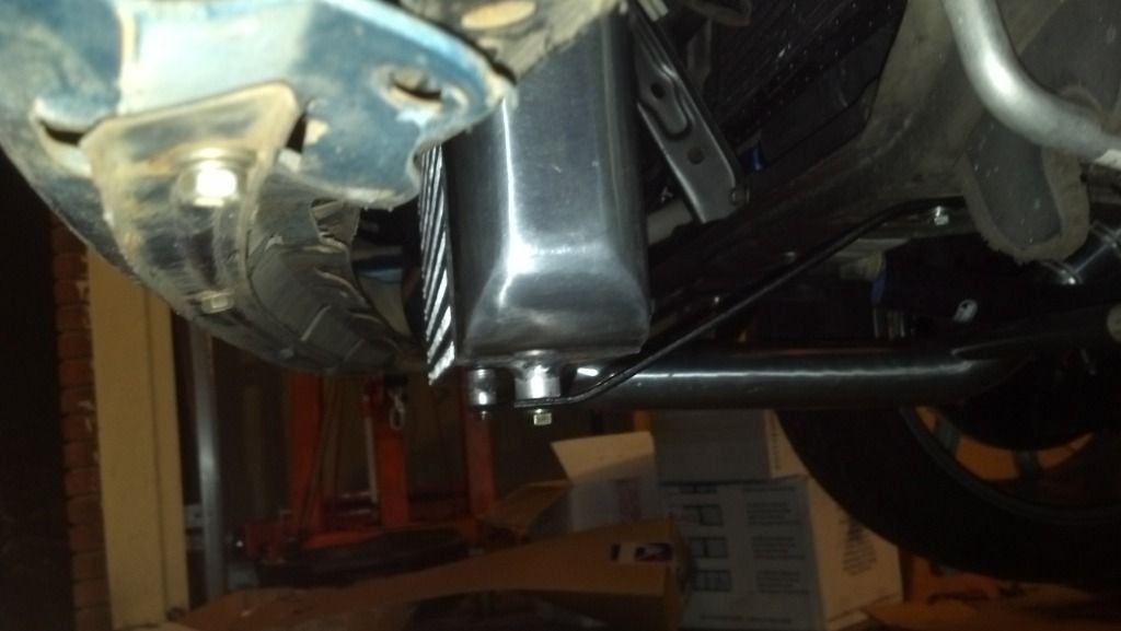

Next I bolted the intercooler in. Then I went to the bottom and removed the two bolts that held the oil cooler lines to the radiator support which is what I used to bolt the bottom of the intercooler to the car. Next I cut two 6" by 2" brackets out of the 1/8th inch steel to use for the bottom brackets. I then measured from the center of the bolt holes on the radiator support to the center of the bolt holes on the intercooler. Next I measured and marked where to drill on the bottom brackets then drilled them out.
I installed the bottom brackets and this made the intercooler solid, I am confident these will hold very well.

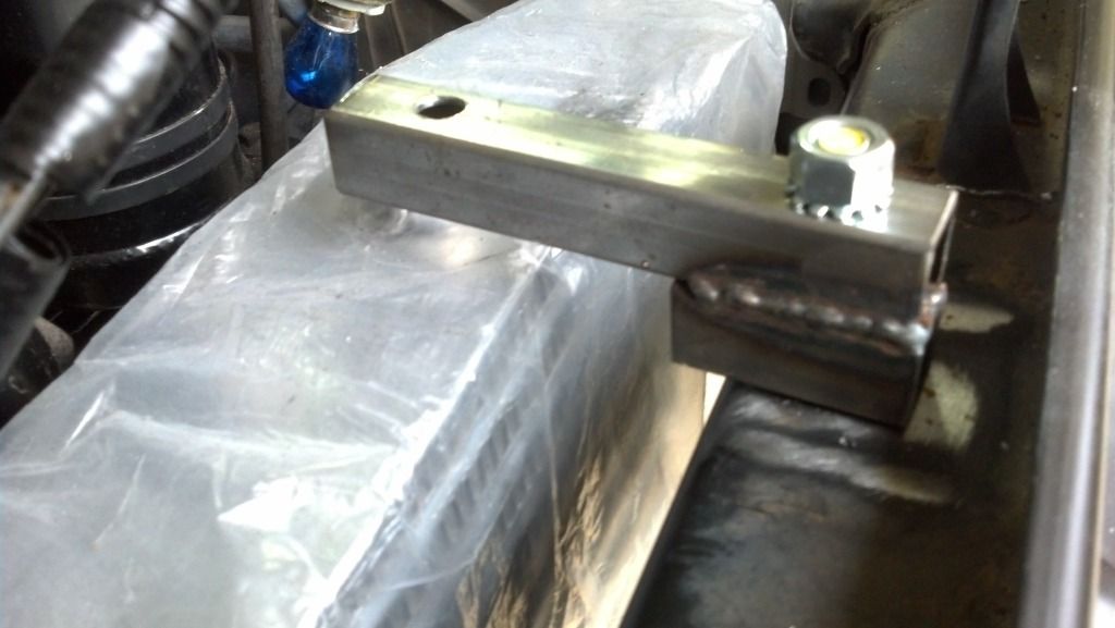

Installed the intercooler onto the pipes, and it rested nicely up against the back of the crash bar. This was too far forward for the brackets that came in the kit to reach though, so I had to make some out of flat stock like the OP. Noticed that this intercooler is shifted to the left due to the outlet being in the way of the right frame rail, but this works out nicely because the lower mounts now line up with the bigger holes in the crossmember. I think they're holes from venting during casting or something. Perfect size for an M8 bolt, so what I did was drill up through the top of the crossmember, securing the brackets using 70mm long bolts with nuts on top of the crossmember. Very sturdy :)
Small M6 power steering line bolt vs. sturdy M8
Prob. could have notched the support bracket that the horns etc. bolt to and got it to fit, but I wanted as little obstructions in front of the radiator as possible (hence the horns mounted underneath). The hood stay is def. not sturdy enough if you delete the support bracket, so I cut one of the unused lower brackets from the kit and bent it to fit. Used an angle grinder w/cut-off wheel (thin grinding wheel) to cut the brackets and radius their edges.
Measuring where to bend
Need to buy a bench vise one of these days lol (using the side of a jack)
Complete. Por-15 or Krylon Rust-Tough enamel is nice for metal brackets.
This intercooler doesn't have the tabs on the side, but I noticed that the top mounts line up nicely with the stock intercooler side mounts. Just had to use the spacers from kit and the brackets lined up perfectly.
Drilled a hole in the power steering cooler bracket on the right
And used the other unused lower bracket and lower spacer.
Right side is too far to use a lower bracket, so you'll have to make a bracket. The "L" bracket that came in the kit worked nicely to mount it though.
Barely enough room under the power steering cooler lines :)
Tried to drill and tap a spot in the crossmember for an oil cooler mount, but the crossmember is too thin in this spot. I have it screwed in there with some red threadlocker for now, but not sure if it'll hold. Next time I'll prob. drill farther back where the radiator mount is and make a longer bracket.
Used the stock oil cooler bracket with the other tab cut off (too lazy to make a bracket for that side lol)
Didn't have to remove or change the lines woot.
