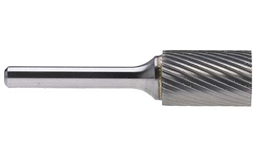

dremel or drill with a cutting bit should shave off the large pieces. then a highgrit bit will make it nice and smooth.

Alex, just use any good file and file the edges and remove the sharp edges. shouldn't take you more than a few mintues. Then spray some paint on it that will prevent rusting and the rest will be protected once you put that grommet on.Hopefully you get this in this weekend.
