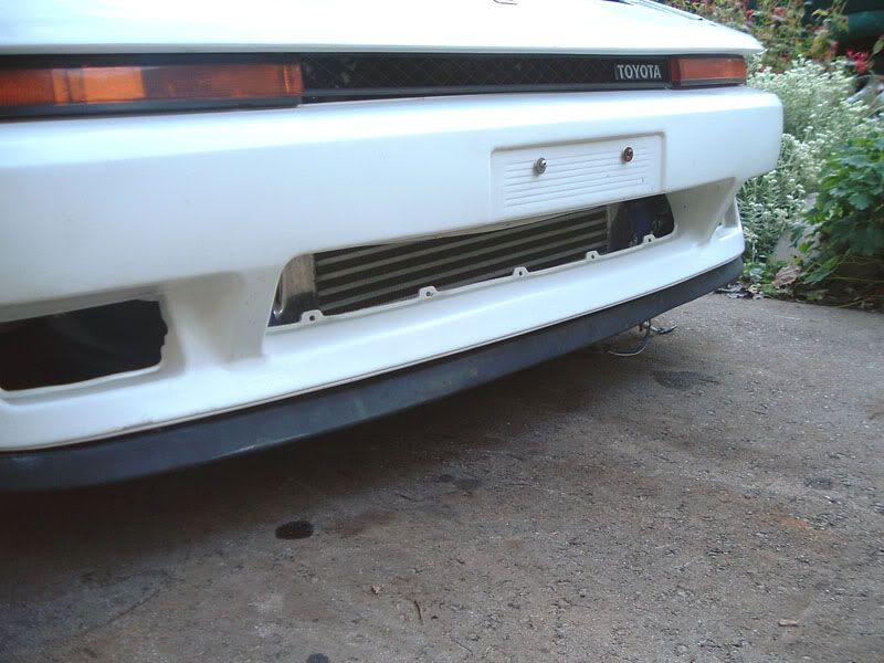

They are linear springs, pretty much everything negative said in this thread is incorrect, if they were progressive coils then ok, but they aren't. Cut them correctly (so they still seat on the perch correctly) and you are fine. Do not cut more than one full coil off, you will regret it as it will be much to low. I had cut mine so that the coil lined up exactly in the same spot, just one coil lower, and the car is low (scrapes on driveways and speed bumps, good thing the stock front lip is so durable, if you have a fibreglass lip, kiss it good bye). Stock size rims/tire combo and the fronts have next to no clearance before rubbing the plastic liners. It is a very agressive stance though, and will therefore require a much stiffer shock.
Get them heated if you want even more improved handling, cut + heated stock coil springs handle better than eibachs.
