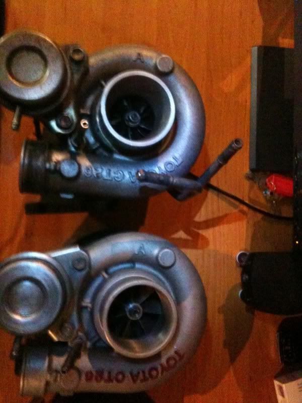

i imagine that the comp housing will be bored out to fit the larger wheel,
here is a picture of my ct26 and ct26 57trim side by side.. it may help you identify what ever it is...

Thats larger than a 57 trim. Appears to be 60-1 or larger.... Although the 60-1 has almost nearly vertical fins.
