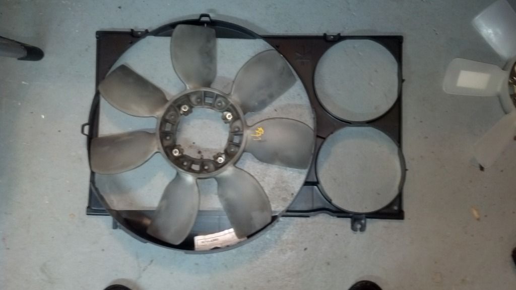

Just wanted to add a pic:
The Lexus LS400 fan is BARELY smaller than the shroud opening, but IMO- too tight to safely run. If someone were so inclined, they could certainly shave a 1/4" from the blades to make it a perfect size.
The problem with that of course, is getting it perfectly balanced afterwards...
