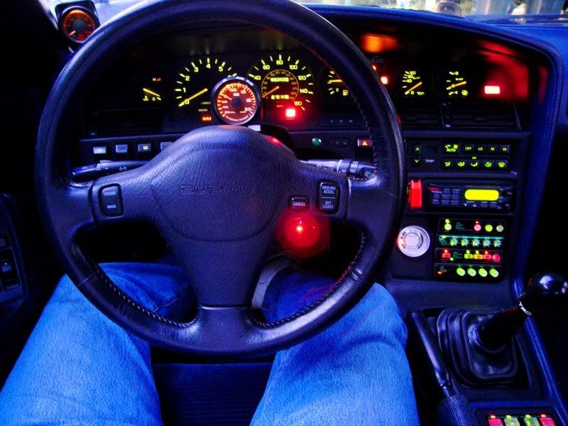

...sorry for the lame clips! Here are a couple shots of the interior... one "at speed", and the other a more recent array of mods. (Yeah, I know... HKS alphabet soup!)

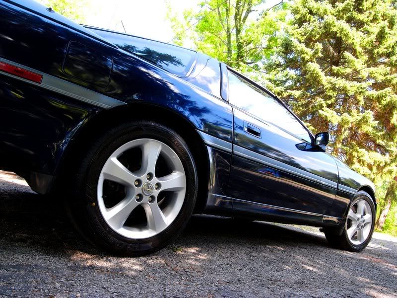

For an old car that sits out in the elements... it's "hanging in there". This shot from about a year ago with my 2004 Solara rims on it!:biglaugh: (I might have posted this awhile back... I think it's when I did a claybar for the first time.)
