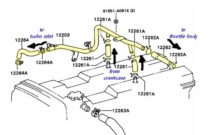

Where does the hose from the throttle body run too? Where I have the label "to turbo inlet" is where the catch can should be located. At low RPM's the system should flow through the TB and bypass the can.

You never answered the question. From the best that I can tell, it looks like you ran the outlet of the catch can back to the throttle body, which would definitely be your problem. There is a check valve in that port, therefore when you're boosting, it shuts that port off, then you're building pressure in your crankcase.
