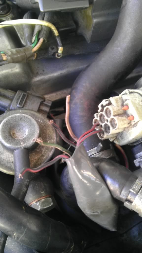

So today i finished my car put new turbo on and 560cc injectors from a evo 8-9 and lexus AFM with 7m Electronics
But with no luck the car wouldn't start just cranks but never jumps to idle. Its is getting Fuel
So then i started wiggling the wires and the car would start to jump to idle 300-500rpm and die right away. (See video below)
[video=youtube;JNb8szwKZac]http://www.youtube.com/watch?v=JNb8szwKZac[/video]
So then i started to look at the CPS wires that were fried and so brittle they broke away in my hand :(
I tried to just twist them together to see and the car cranks but never jumps to idle.
So here is what i'm left with.
Quick question witch wire from the harness goes to the 3 wires from the cps? (Black or yellow)

87supraguy;1798068 said:
Carlin has a CPS. where are the wires broken exactly? on the CPS side of the connector or harness side?
Both Sides Clip fell apart.

So now i got the CPS wired correctly now it is back to doing the same thing it was doing in the video wants to stay on but doesn't but atleast its getting past the cranking point
EDIT: I can hear fuel pump and injectors when i jump FP and B+

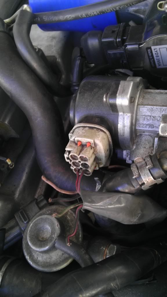

So today i decided to just hard wire the injectors to the harness. but as i was puting everything back together noticed the two wires from the Idle air control valve had come out of the connector. As soon as i started touching them they all broke off.
Could this cause the car not to start ?
Where can i find pigtail connector for the idle air control ?
IBoughtASupra
Mar 10, 2009
4,455
Queens, NY
It would give a hard time starting, so you'd need to keep the throttle open for it to idle.
Man, you need a better harness. That one just looks brittle.
