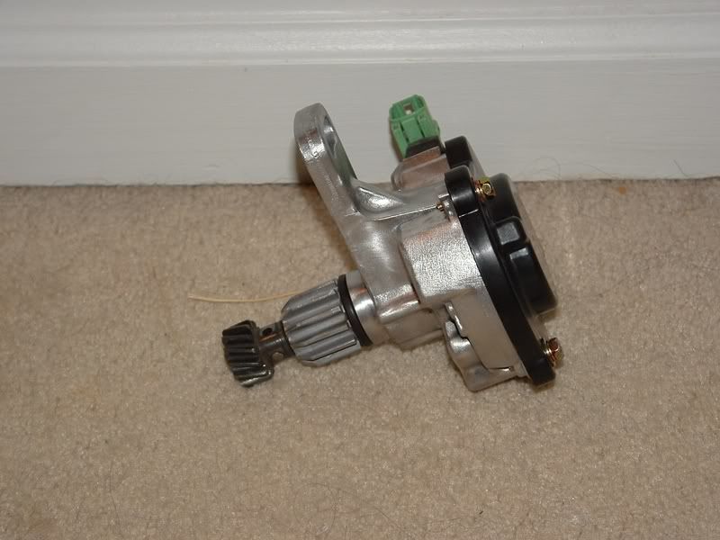

I have a source that will refurbish one and warranty it for 30 days. Comes all cleaned up inside and out, new cap, new gasket, new O-ring, and greased with a white lithium grease. He wants $125 + shipping on them. Here is a picture of what it will look like:

^^ sounds like a great deal. please pm with for some info.
