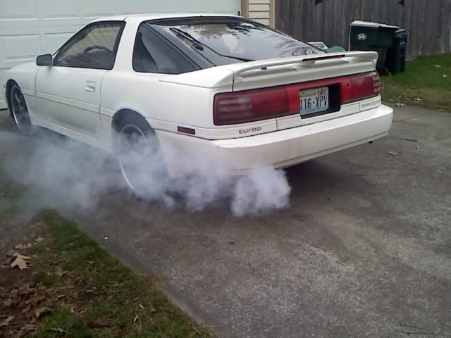

heres the smoke.
did a compression test, cylinder1-160 cylinder 2-5, 145 cylinder 6-150
is it safe to say its not a bhg? and that its the valve stem seals or maybe valve guides?

smoke only appears on cold start. and it appears on hard acceleratin. like if im racing someone. then at idle, it will smke for alittle bit till i drive off.
AJ'S 88NA;1832655 said:
Looks to be a little more than valve guides, is that at just an idle?
this is at idle.
Supracentral;1832657 said:
I'd suspect turbo seals or a cracked CHRA with that volume of smoke...
i looked before and after turbo for oil and found none.and not sure what chra is.
