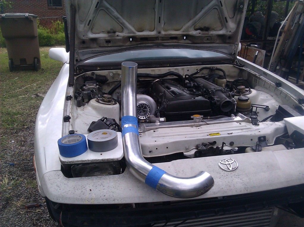

I know you said OEM, but I saw this on the other forum and it looks awesome:
He claims it's from optionsauto.
