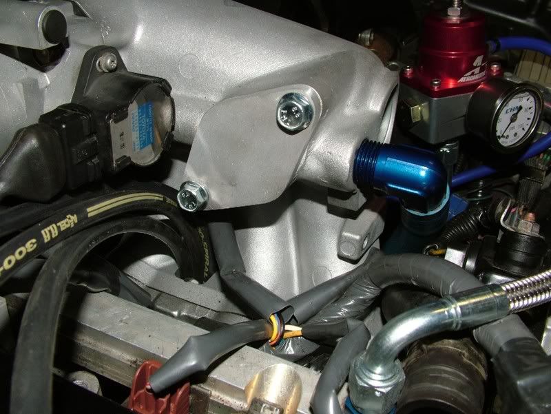

aaah I see... but am I totally stupid?! Didn´t you block off the isc in this pic?!
you did that to remove the hose and the pipe that goes across the valve covers... thats the fact everyone wants to do it as I think :icon_bigg
But wheres the isc gone if you blocked it off in stock location? :confused:
edit: I´m stupid... read it on page 5 :biggrinki
The hose goes to the isc :icon_wink
Actually it will go to the isc but I ran out of time to get it done before Vegas and I put it back temporarily.
And I'm sure you are not totally stupid. LOL
