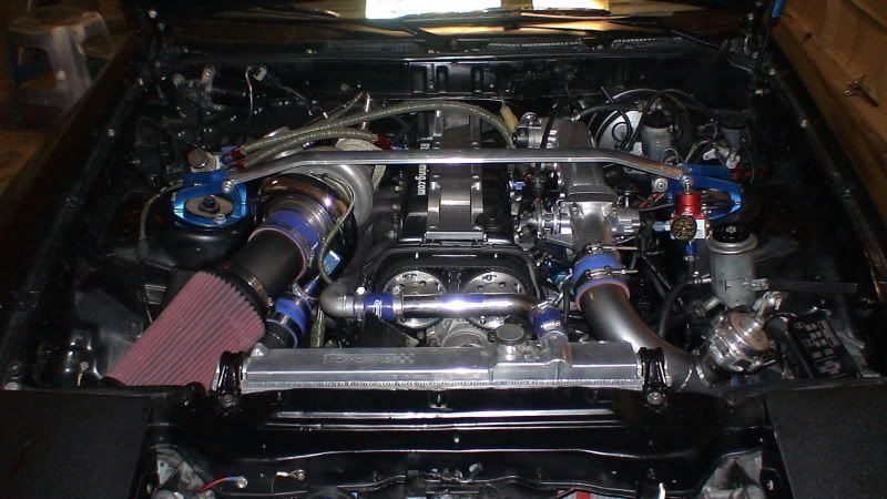

not sure on if its the race radiator, not sure what it is really, my friends fan tore it up, i fixed it after that. i had a factory shroud, but it was in bad shape, came loose and got torn up. i need to find a new one
edit: whichever one the radiator in the picture is, thats the one ive got

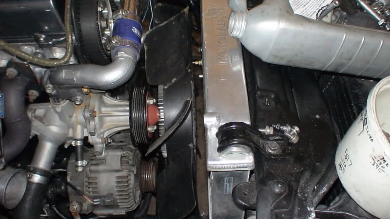

here ya go, Koyo Rad + GTE clutch + GE fan

look's tight to the radiator hose.does the fan flex at high rpm's?i'm not familiar with the clutch fan set-up's on these car's.
thanks for that pic

it does look tight on the back, but each blade is notched
even revving it out, it flexes a lil, but completely clears front and back
