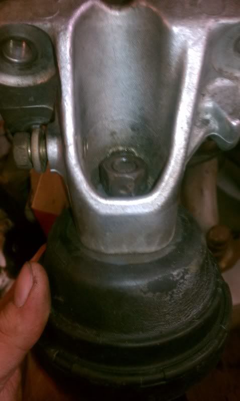

Sounds like the crap that they're tapping and drilling are some 12x1.5 lug nuts and making them into 12x1.75 nuts, so that they can be used to reach down thru the mount points on the aluminum mount plate and the lower plate, to fully engage the threading on the mount itself. Looks like your pic shows that the ford mount has slightly shorter studs?
Just a guess.
Ps- have you installed yours yet?
