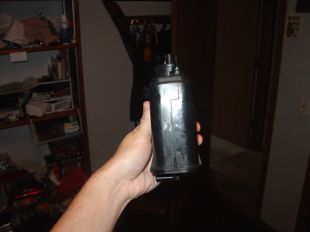

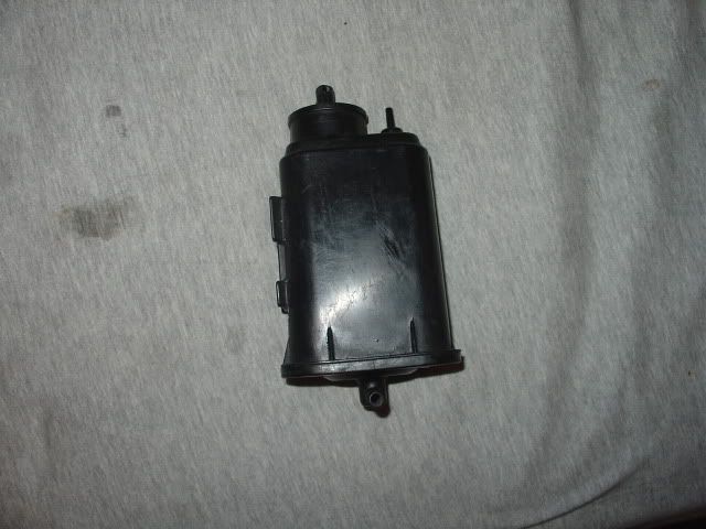

I should go take a picture of the stock one next to a JZA70 one...
Here's the size of the JZA cannister:

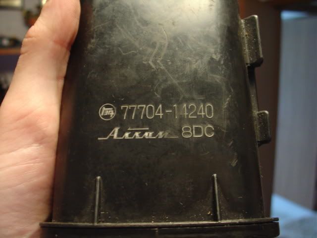

And picture of the part number...
