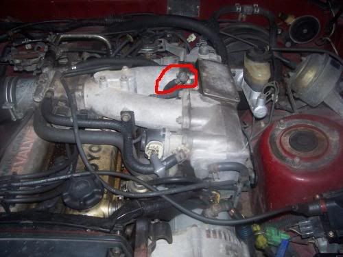

turns out my battery was dead. i just got a new one so now i have power. but theres another problem, when i go to start tha car it cranks but that thing(valve? seems pressurized) at the top of the intake manifold spits out some oily liquid shit, so i now i gotta replace that line. btw wat is that thing called. i'll try and post some pics up.
(BTW this was taken before the spark plug/wire change.)

thanks bro! u kno where i can get that line at? because its cracked and i can see that it has like a smaller line inside of it. maybe autozone??(hopefully lol)

I think AJ's right. That's a pressurized fuel line that is a shrink fit to the two banjo fittings(one on inj., one on the fuel rail). Auto Zone does sell a repair kit that you can use to replace that type of line, but I've never had good luck with it. Always winds up leaking again, and I wind up going to the dealer for the correct part anyway.

is it squirting out "some oily liquid shit", or is it gas??
