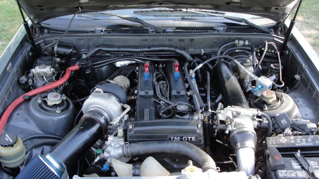

Follow the red line on the left side:

I was told the other day, that if the catch can is not rerouted back before the turbo, that I would need to run a vacuum pump for the engine.....is this true? First time I had ever heard that.
IBoughtASupra
Mar 10, 2009
4,455
Queens, NY
No, that is not true.
You should have vacuum for any catch can. Some people vent the can which is like leaving the PCV open to the atmosphere.
It's best to have the valve covers to the inlet and vacuum pull on the outlet as that is what pulls your fumes and vapors out to the cover.

Ok, so now, lets say I route mine like Toyotanos does. Should I cap the PCV on the throttle body? Or just throw a filter on it? Because my next purchase is going to be a catch can, but I want to be sure I have it routed correctly to get the best performance from it.

Actually, the ideal system would take that top port on my catch can and run it to a vacuum port to maintain PCV circulation at all times. It has to be a small orifice, similar to what the factory port has, because it becomes a boost leak when manifold pressure is positive. That way when manifold pressure is negative it pulls the vapors into the engine to be burned off, and when its positive, it helps move the vapors through the piping into the turbo inlet for better evacuation! That's how a PCV system is supposed too work! Movement of gasses is the key.

Not necessary, you want the gasses to be moving, otherwise it wouldn't be positive ventilation. You want it to flow both directions so its working right all the time!
