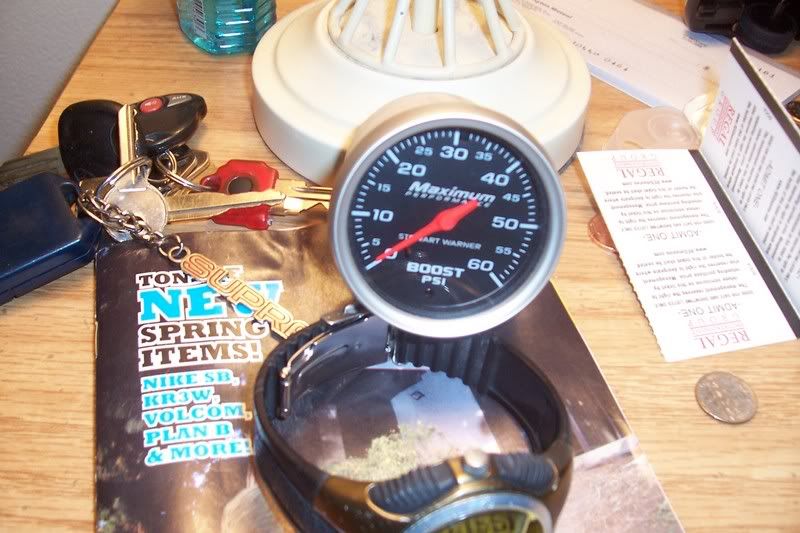

I put the new slave cylinder and hardline in earlier today and replaced the broken ISC hose with a piece of 5/8" heater hose. I have a driveshaft on the way. I also hooked up the speedo cable and put my boost gauge in. I just shoved it into the ashtray slot for now. So now all thats left is hooking up the IC piping and the driveshaft. And then it's on the road.

I guess I hooked up my boost gauge wrong because it's not reading boost. I'll fix that another day tho.

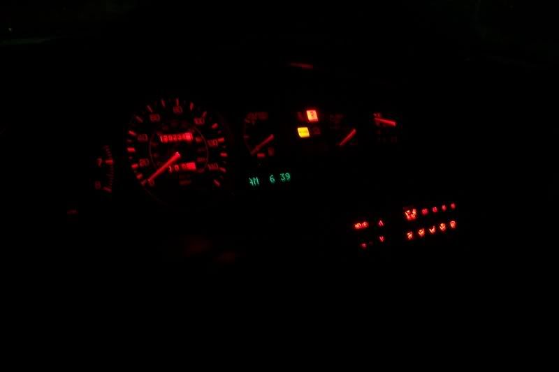

Well, tomorrow I should get the short rubber clutch line tomorrow. And if I do, I'll definitely have the car on the road. A couple more pics.
Red dash LEDs. Some of the lights look dim but I can assure you they are all mighty bright. But like some have said, you can't see where the redline starts. O well. We all know where it is anyway, lol. And the picture makes some of the climate control lights look orangish but they are red also.

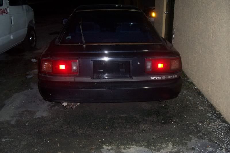

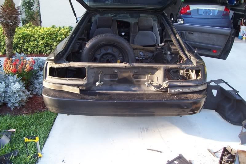

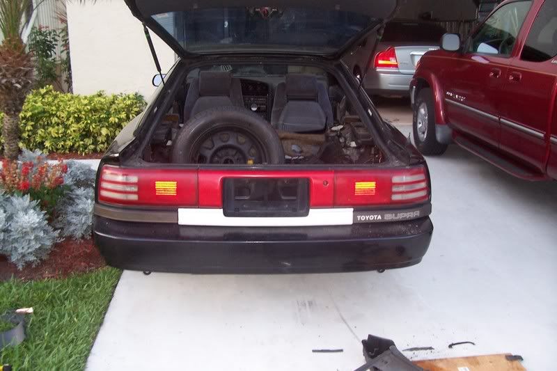

I switched out the steering wheel to an 89 (which is much more comfortable than the 86-88) along with 89+ taillights. I only have a pic of the taillights right now. I've also replaced the spark plugs which I gapped to .32 and I replaced the spark plug wires.
Before
During
After
