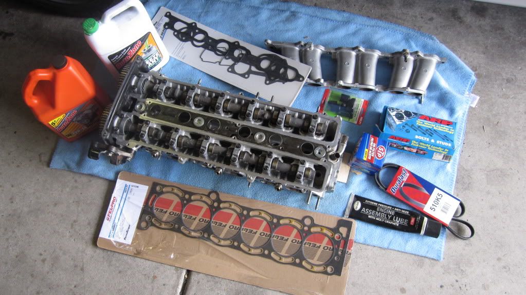

mkiii222;1649735 said:
Stock gasket won't cause future problems if:
The head isn't warped
You use ARP hardware torqued down properly
You don't plan on 500+ hp
Usually just getting the head machined is anywhere from 80.00-120.00 then having them rebuild it ect costs more..
Here is mine after I got it done..
