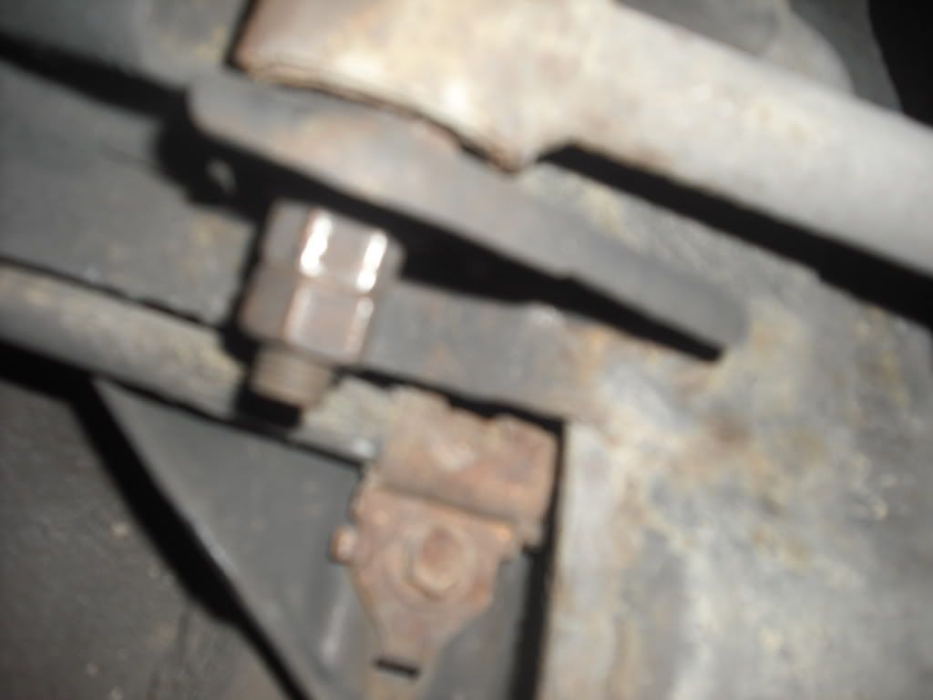

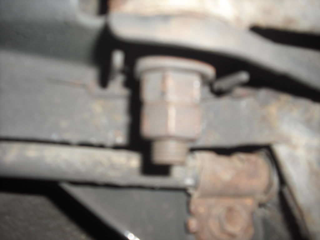

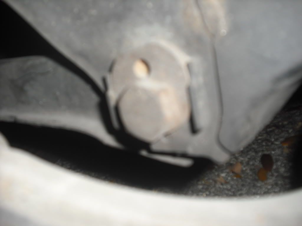

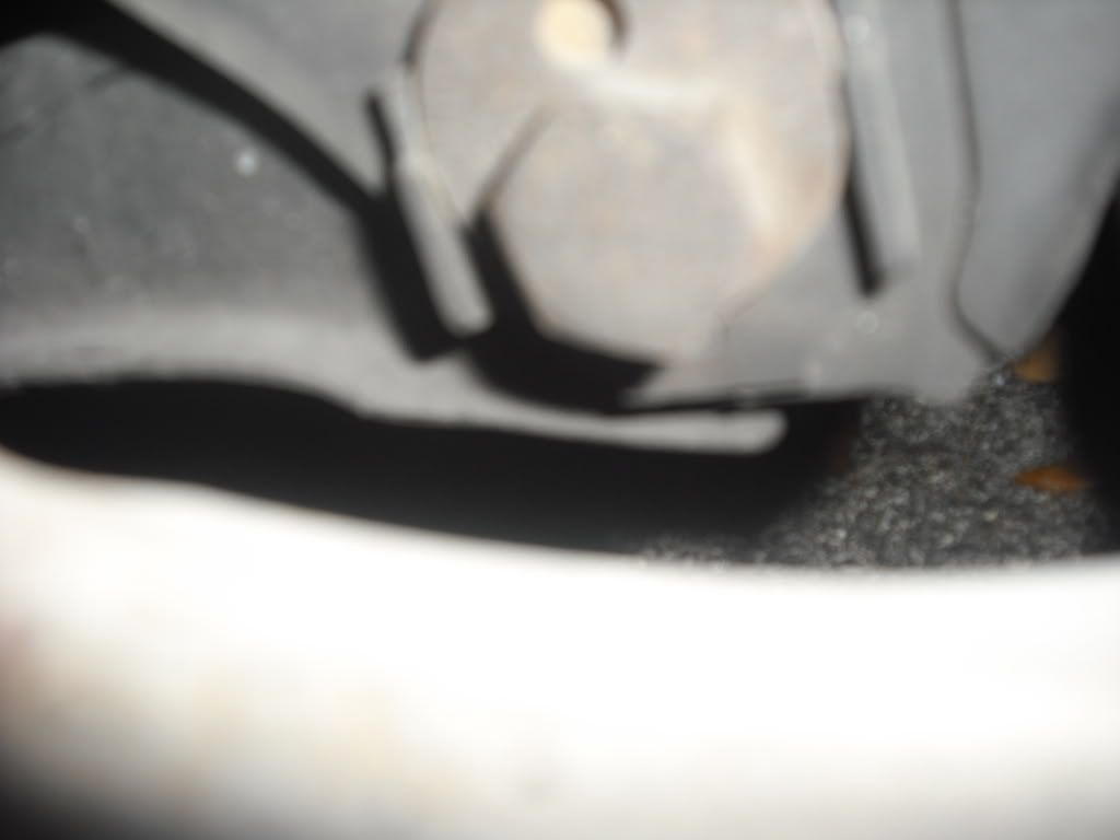

this is what im talking about in the right rear that the camber bolt is not the same as the left side.
Also would not having the rear sway bar connected affect its camber?

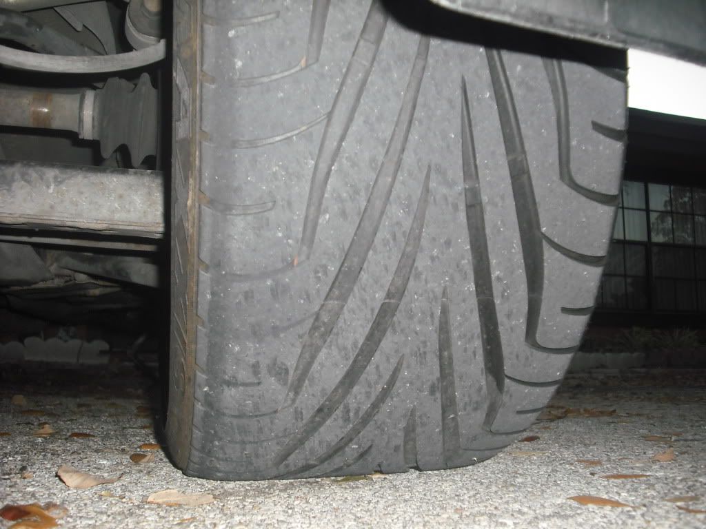

how the rears are looking :/

WTF IS THAT CRAP!?!?!
Considering that bolt doesn't even use the eccentric anymore and looks extremely questionable I'm surprised the shop even touched it. Put that crap back to stock.

i have no idea...im going to go look for the stock bolt:3d_frown: didnt notice it until the guy pointed it out....

Can you get a pic of the adjuster cam on that bolt?
No the sway bar won't affect the camber setting while it's stationary.

i will test the buddy thing tommorow its to dark to see i did get the pic of the bolt. one sec

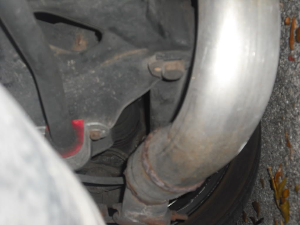

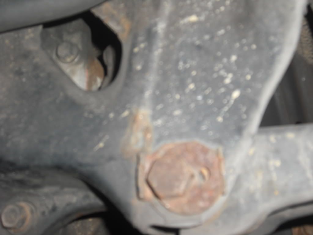

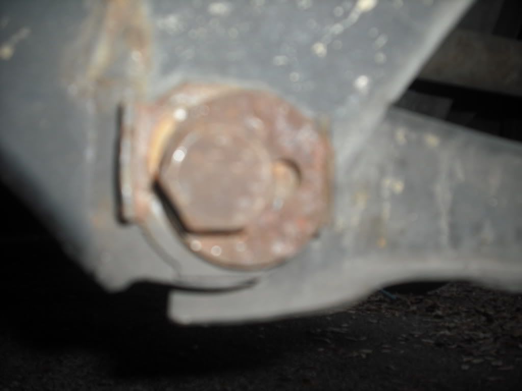

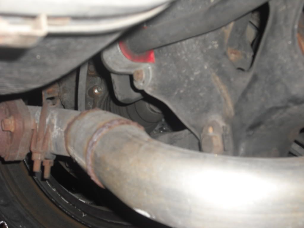

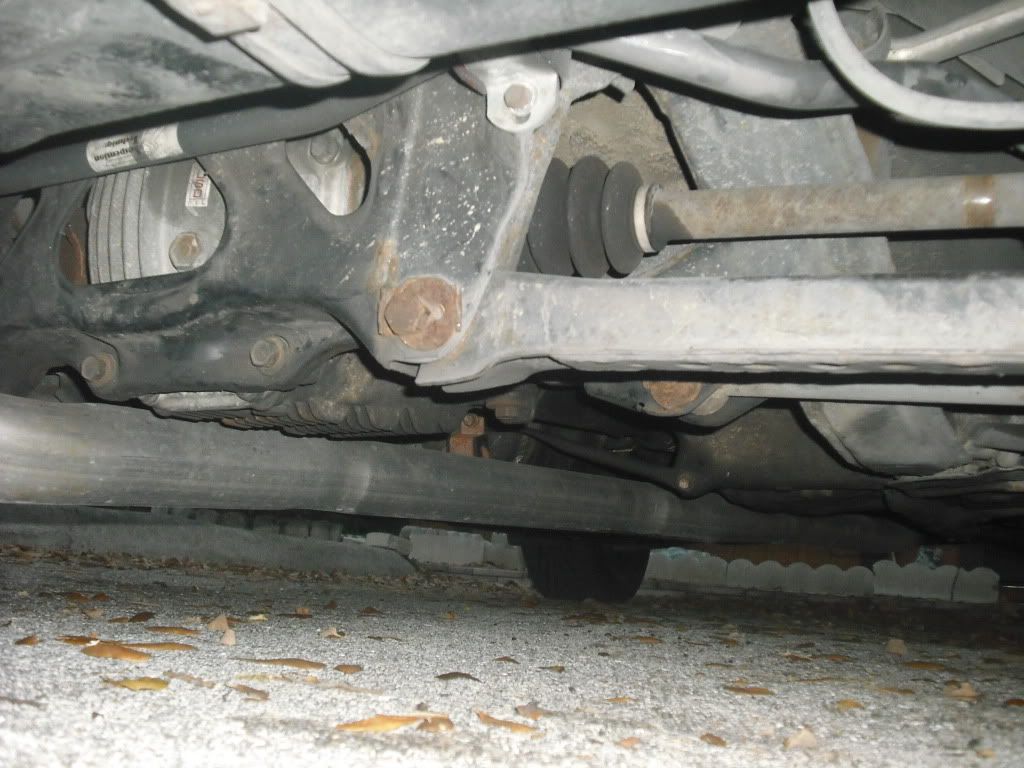

this is how the other side looks. (rear left)
(i have red poly on the sway bars that arnt connected :/)

the first 3 pics are the one with the 2 nuts on them, and the last 4 are the left side which didnt have a problem. OH i almost forgot the guy who did the allignment showed me that the front left wheel had like a bump? like he spun the wheel and it wasnt smooth there was a spot that jumped he said it could affect the allignment. how can i tell if the rim is bent or its just the tire? and could this also be why it wasnt successfully alligned

Tire jumped or the rim jumped?
Nope shouldn't have affected the alignment as it's done static.
Just wondering if the dodgy bolt has the machined flat for the cam or of some genius has just drilled a hole in the cam....

i have no idea i plan on going to the junkyard and pulling a camber bolt and swapping it out, i guess i will have to find out when i take it out :s

last question. would the tires being stretched affect the way the thread wears out? atleast on the rears. 255/35/18 on 18in 9.5?
