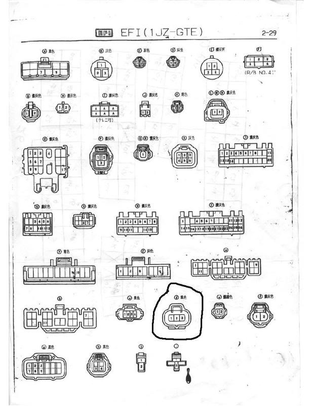

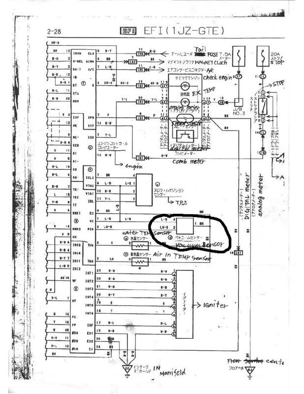

Hey guys I have this plug on my harness and I have no idea where it goes. I've got circled in on the TSRM with my beautiful MS Paint skillz (don't hate).
Thanks in advance.

As it says on your diagram, that's the map sensor plug. The map sensor is just a small plastic box with a vacuum port on one side and that plug on it. The 1jz won't run right without it.

That plug is located on the wiring hanress, the snesor itself is located on the chassis though, its a 3 wire plug. You will need one though. I still need one as well.
