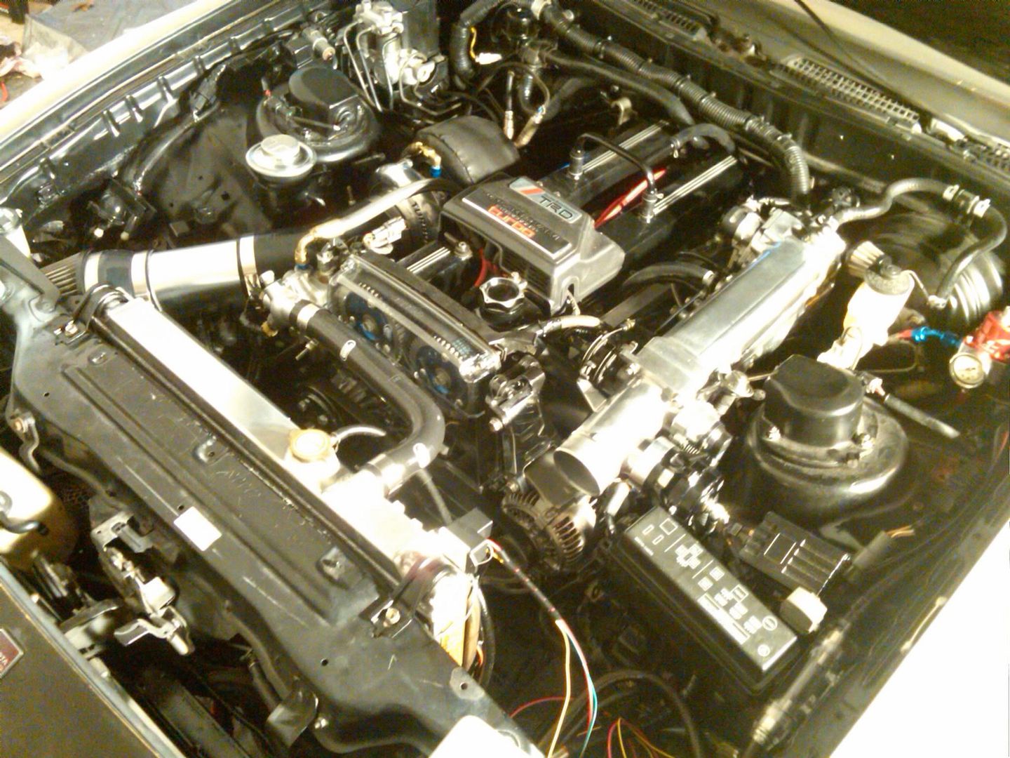

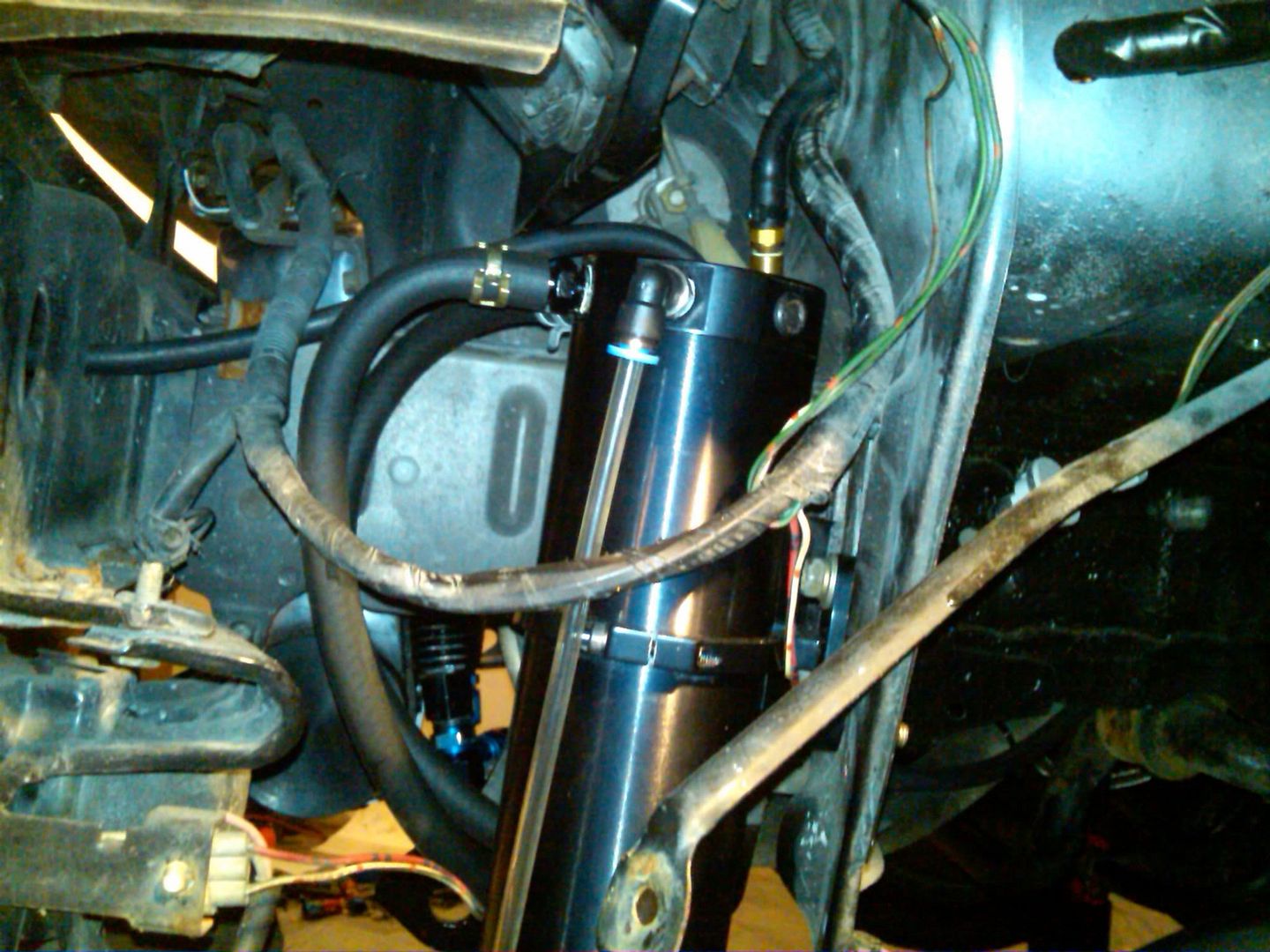

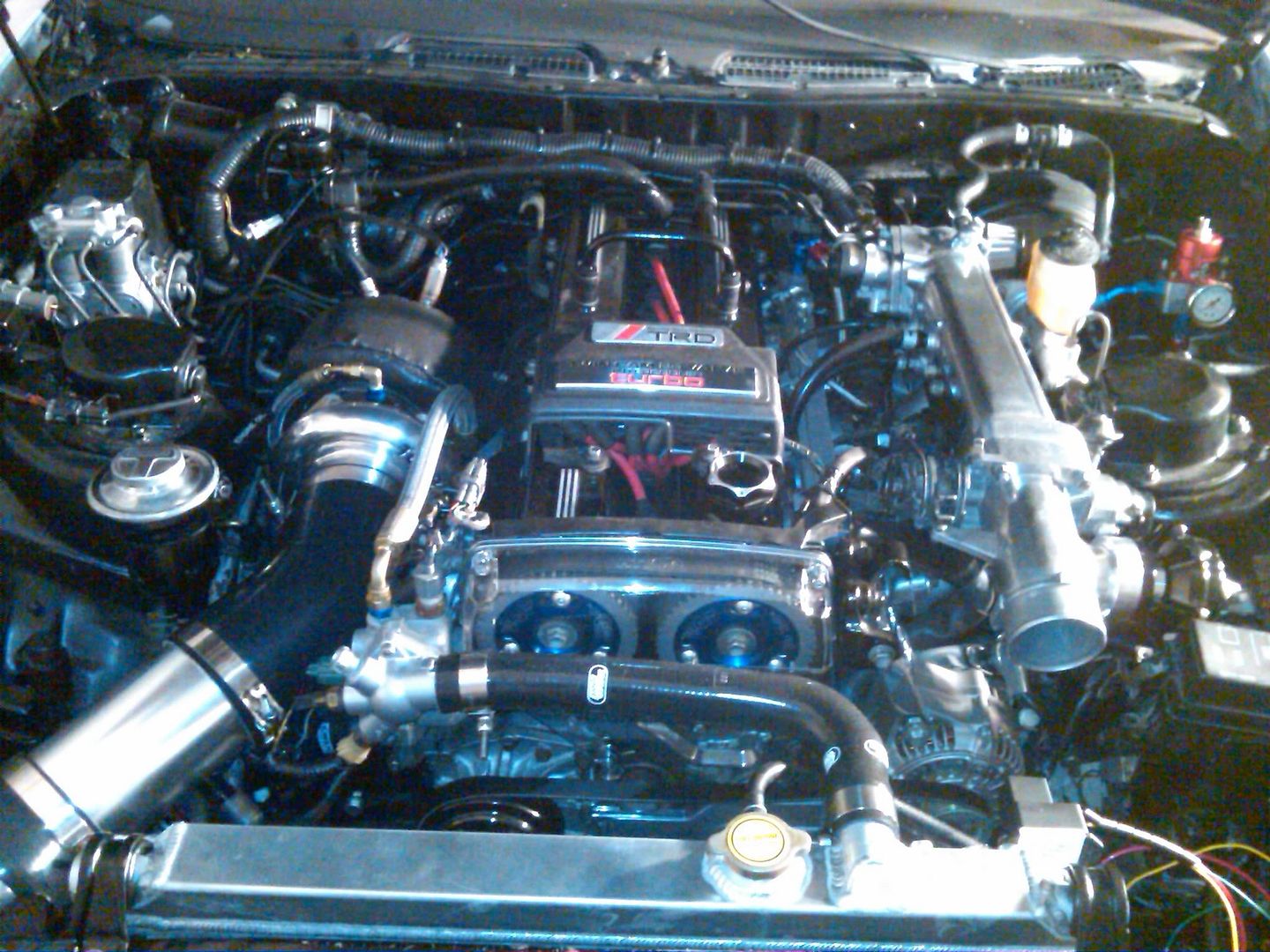

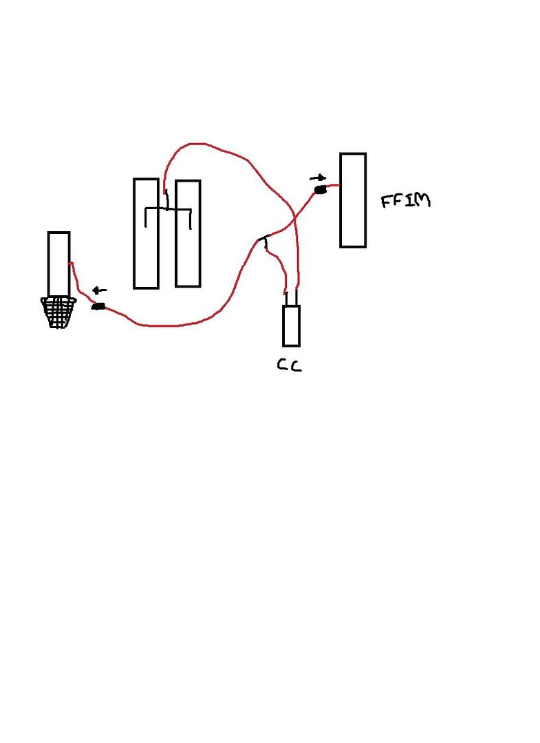

Here ya go.
I never actually ended up putting the one-way valve to the intake pipe like what's pictured in the below diagram. As IJ had previously pointed out in another thread, it is not needed.

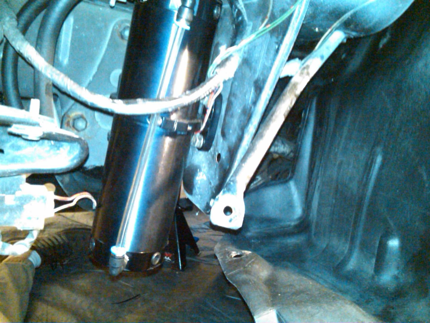

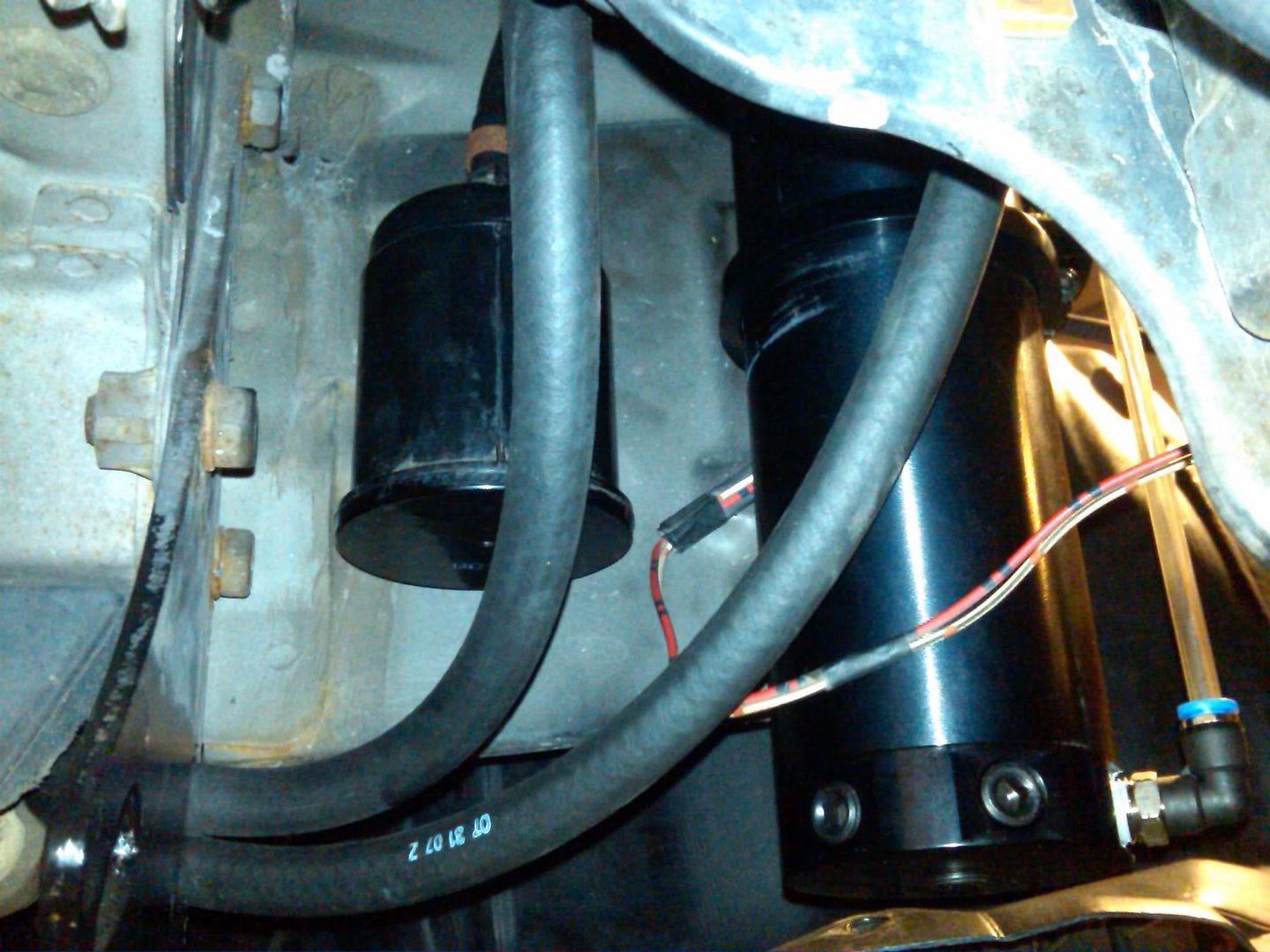

Catch can located under driver side fender:
