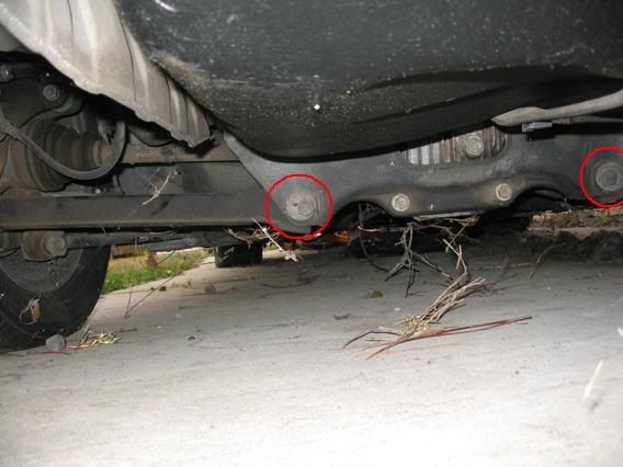

Here is how Camber is adjusted.
Also this is A1's site, you can find adjustable camber rods, etc.

Unlike some cars, our cars have a fully adjustable suspension geometry. Any reputable suspension shop can adjust our suspension.
The cars they are telling you that they can't adjust are cars with McPherson struts. This is the reason people need camber kits for them. They probably saw your car was an import and naturally assumed it was McPherson strut based.
Dirgle
Conjurer of Boost
1,632
Pauma Valley, CA
Those bolts have degrees markings on them. You can dial in the amount of chamber you want by rotatin them. They are basically elliptical rods. As they rotate clock-wise and counter clock-wise the pivot point for the lower A-arm changes.
