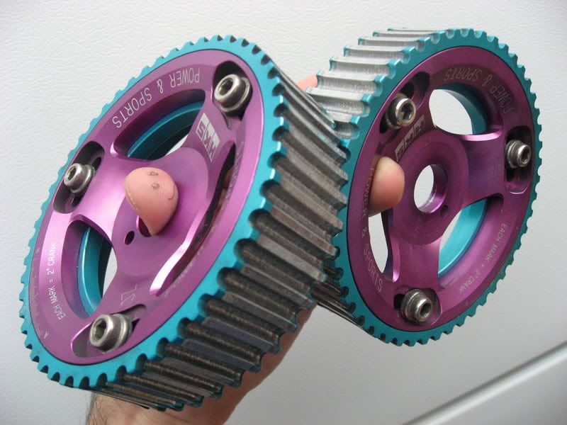

I picked these up right quick of SF. I am not sure if it is excessive to the point that the timing belt would slip. I am kind of annoyed, but it was an impulse buy so I had it coming I guess. Now I know why they only show the front and back in all the 4 sale threads I have ever seen.

Yup HKS. I'd think it's cuz they are aluminum that they wear like this the stock ones would probably be the same millions of miles later. So does anyone have input as to whether this is a no go via belt slipping on the teeth???

yeah those are no good. toss em in the trash. but, if you hate to throw your money away like that ill be happy to take them off your hands. cash plus stock cam gears if youre interested.

I am guessing it is normal to wear down cuz they are alloy not steel, but I am just curious as how much is slipping much.
lagged you are indeed smokin way more one should. If they are worn too much, I will just toss them on ebay at what I paid.

It was a known issue with those Pullies, there were a bunch of posts about them on SF.
Looks like they were only anodised and not hard anodised like they should have been.
