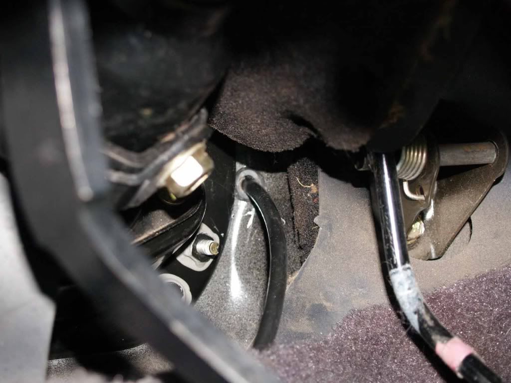

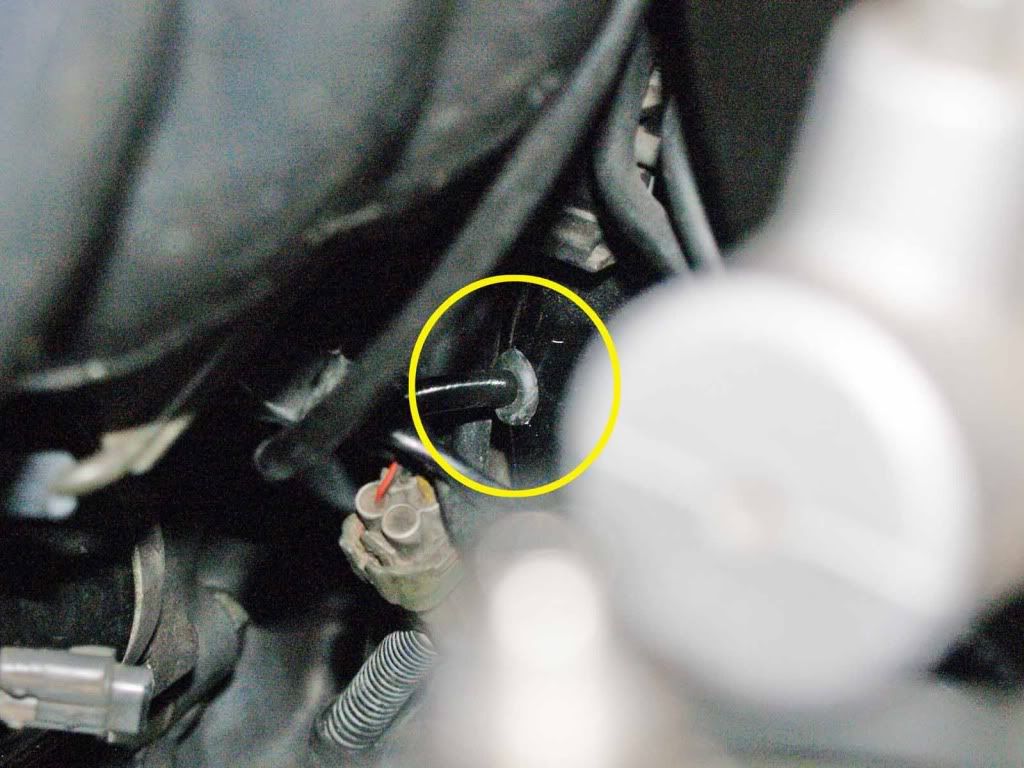

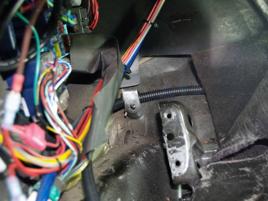

Next, I had to drill a hole in the firewall for the Water/Meth Line routing. A 3/8" hole for a 1/4" grommet. Worked gooduh!
Then I started routing and looming...

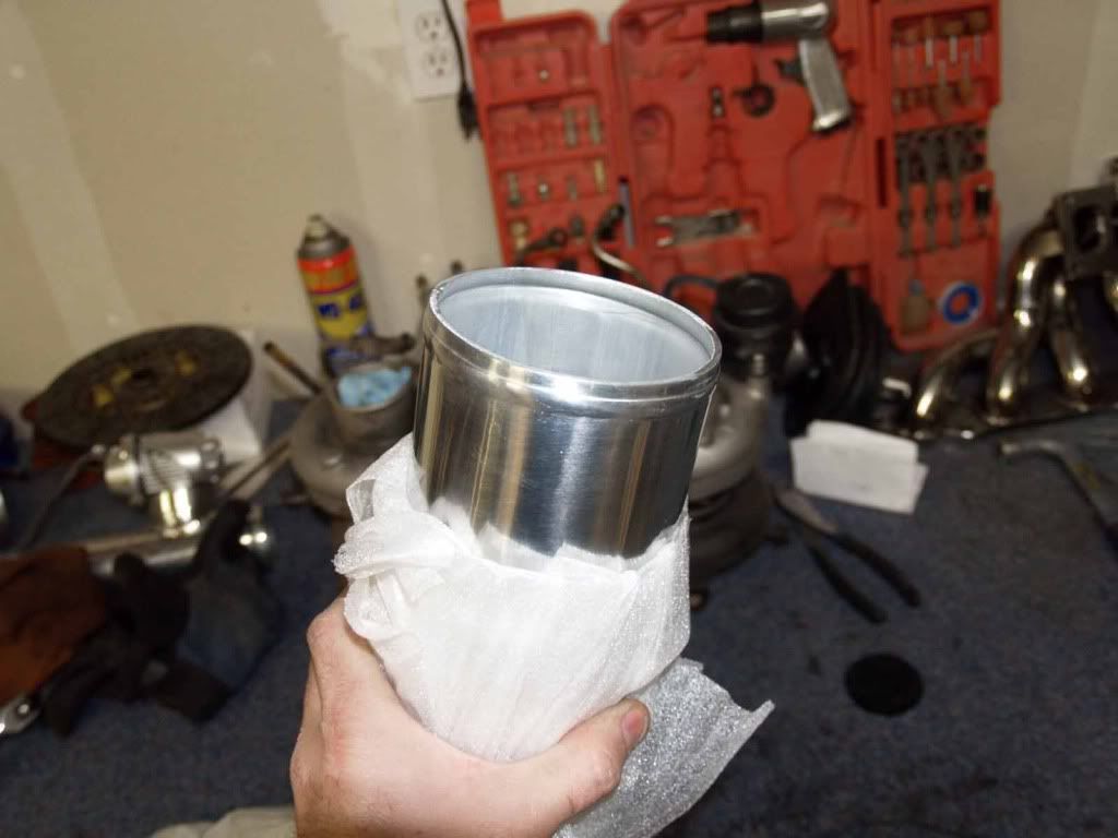

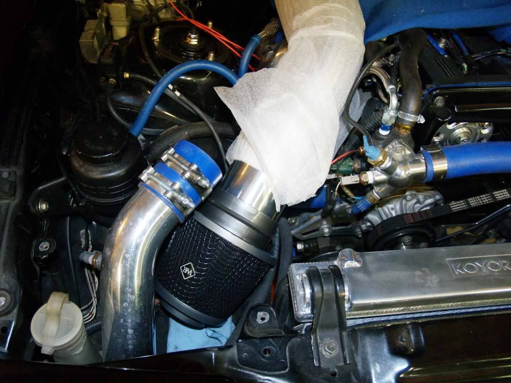

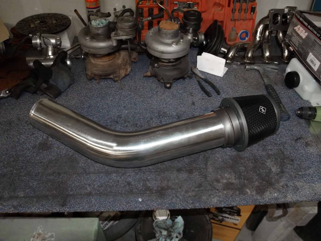

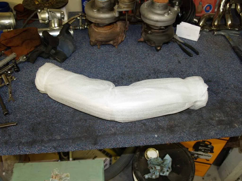

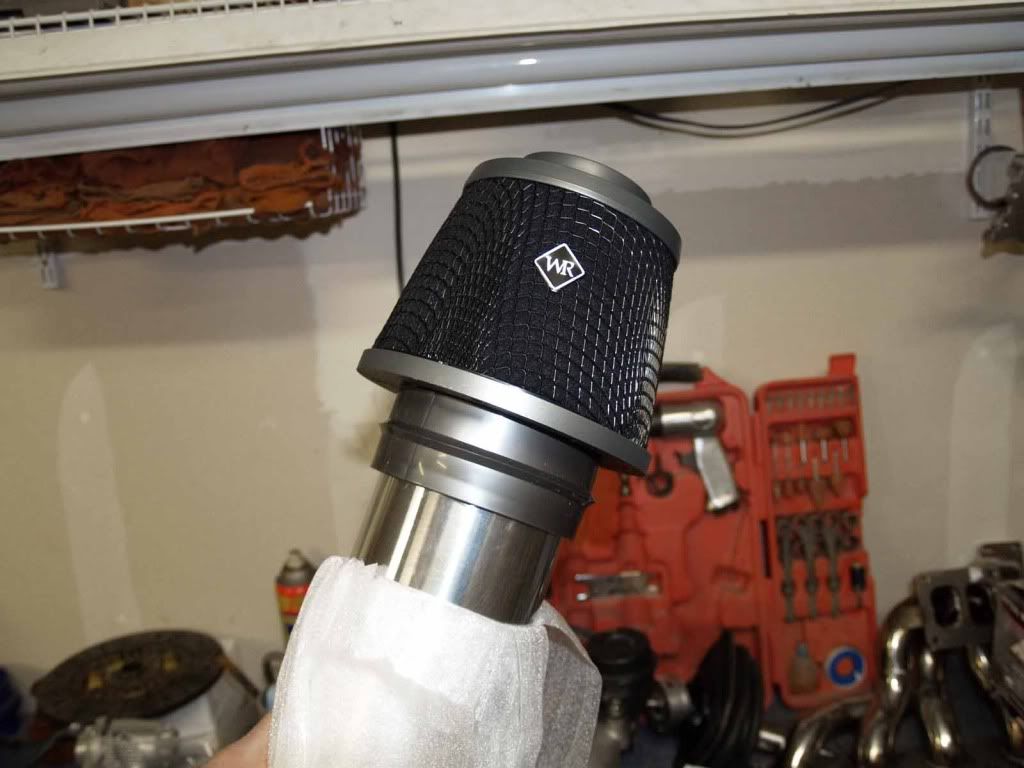

Then I unboxed this little goodie from Driftmotion. A 4" 45* Intake pipe.
Here's a little test fit...

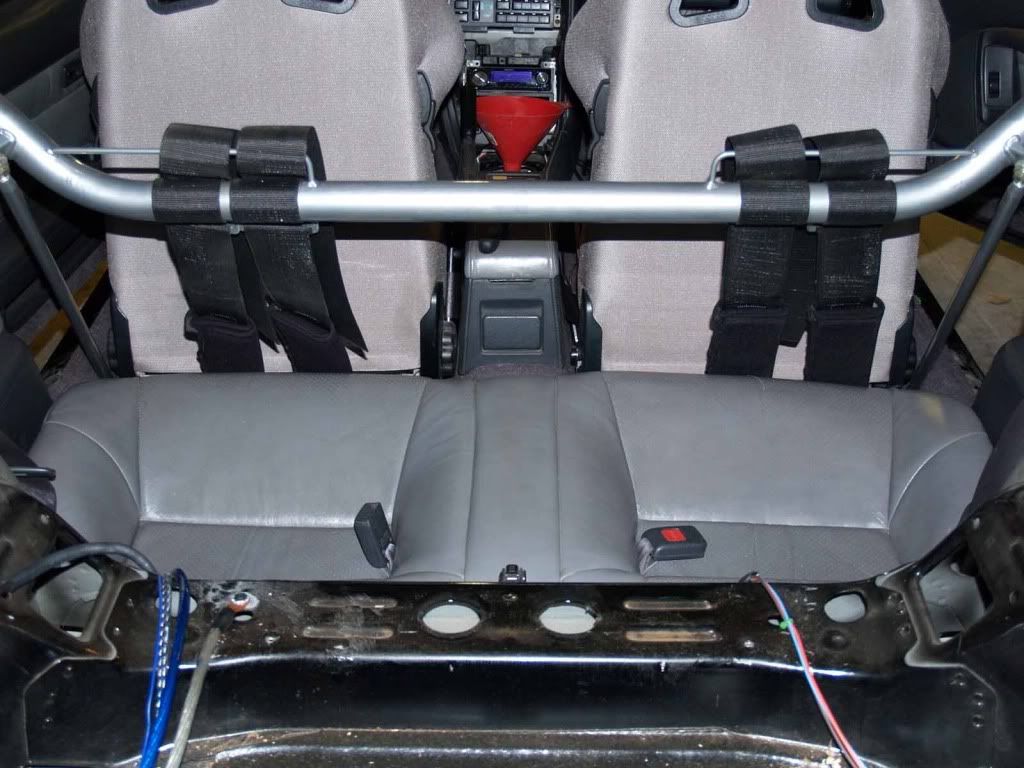

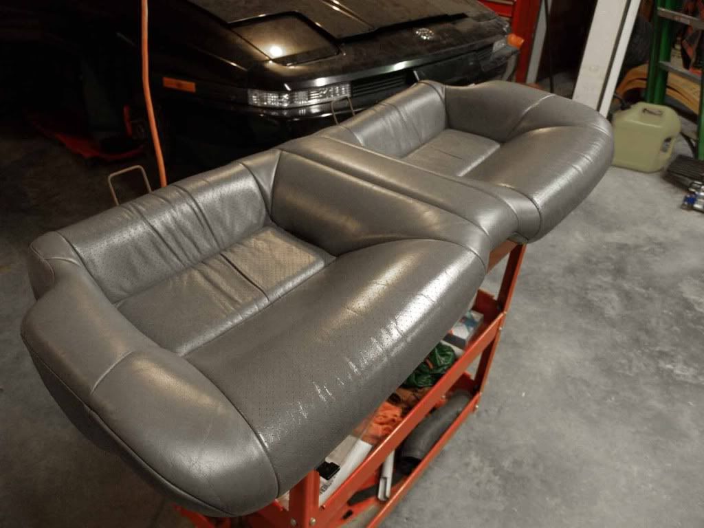

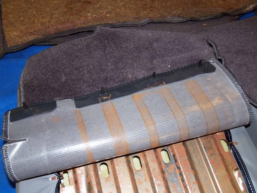

Now that the Water/Meth line to the pump is run and the control lines to the pump and Meth tank level sensor are run, I started putting the rear interior back together.
Here is the "new to me" rear seat. Some may remember earlier pics I posted of the original ones. They were quite ripped up from the previous owner...
Special THANKS goes out to Fred here! :D

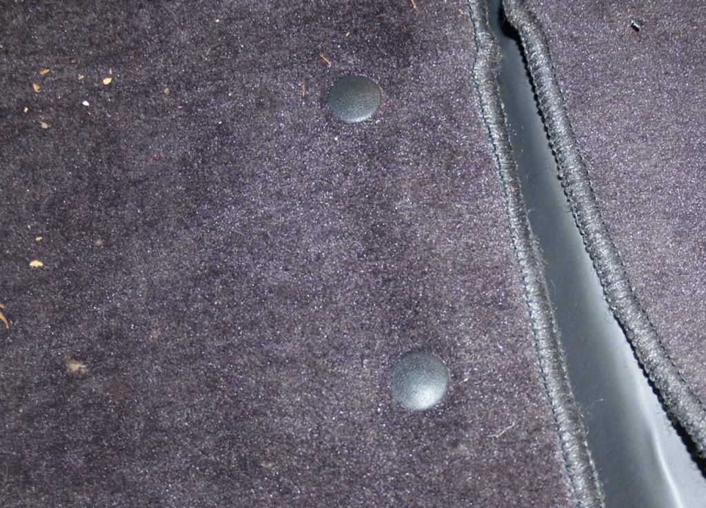

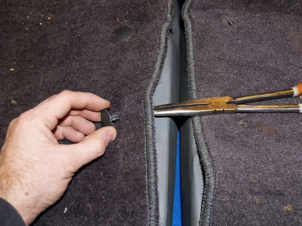

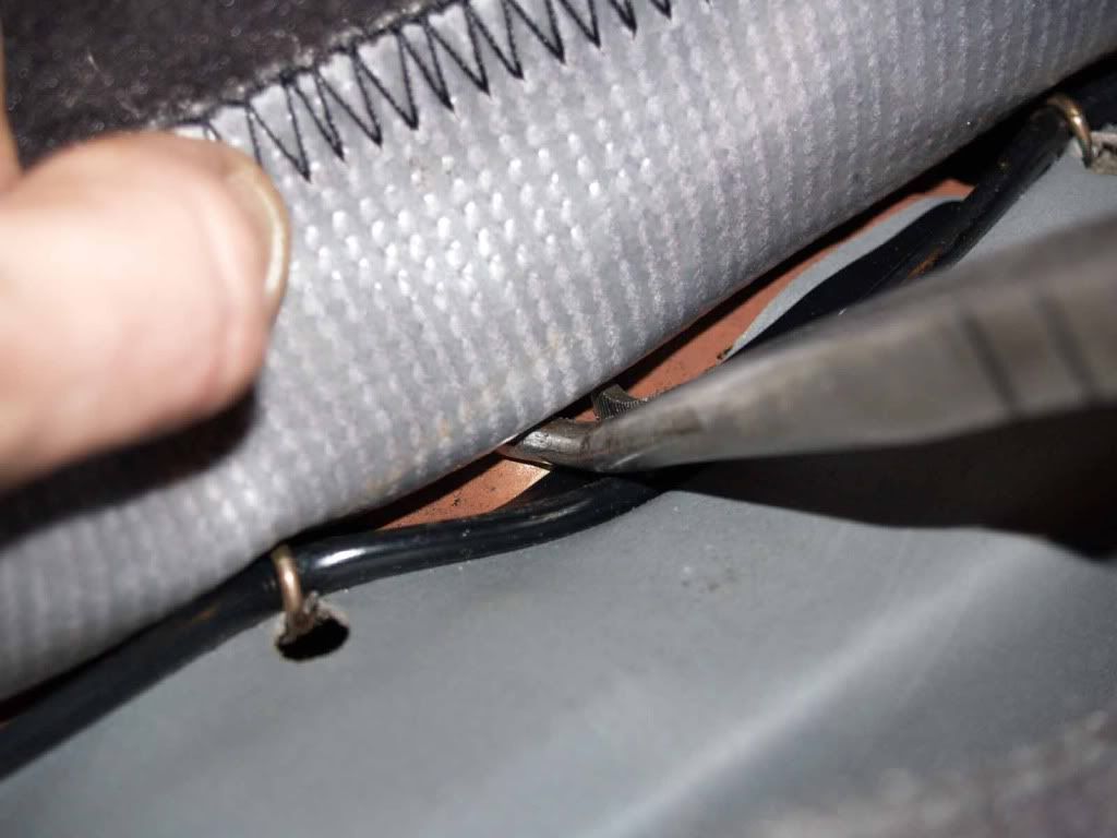

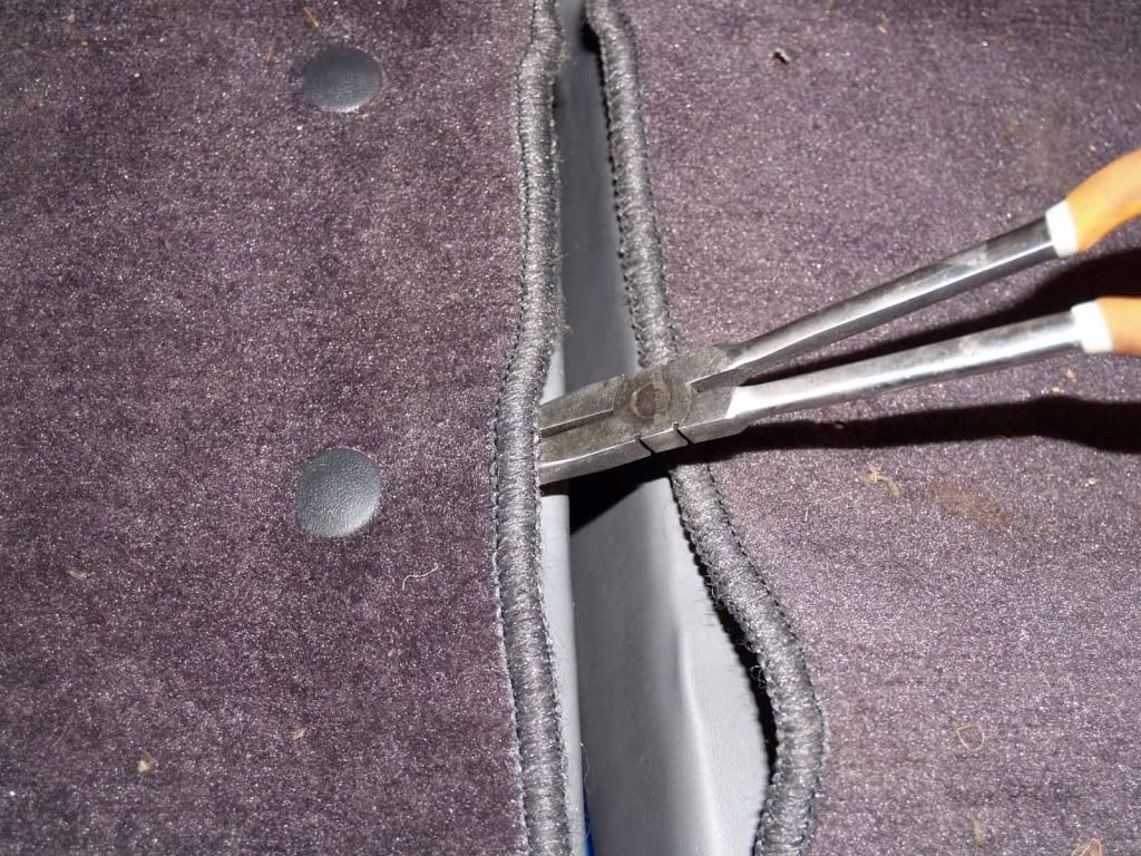

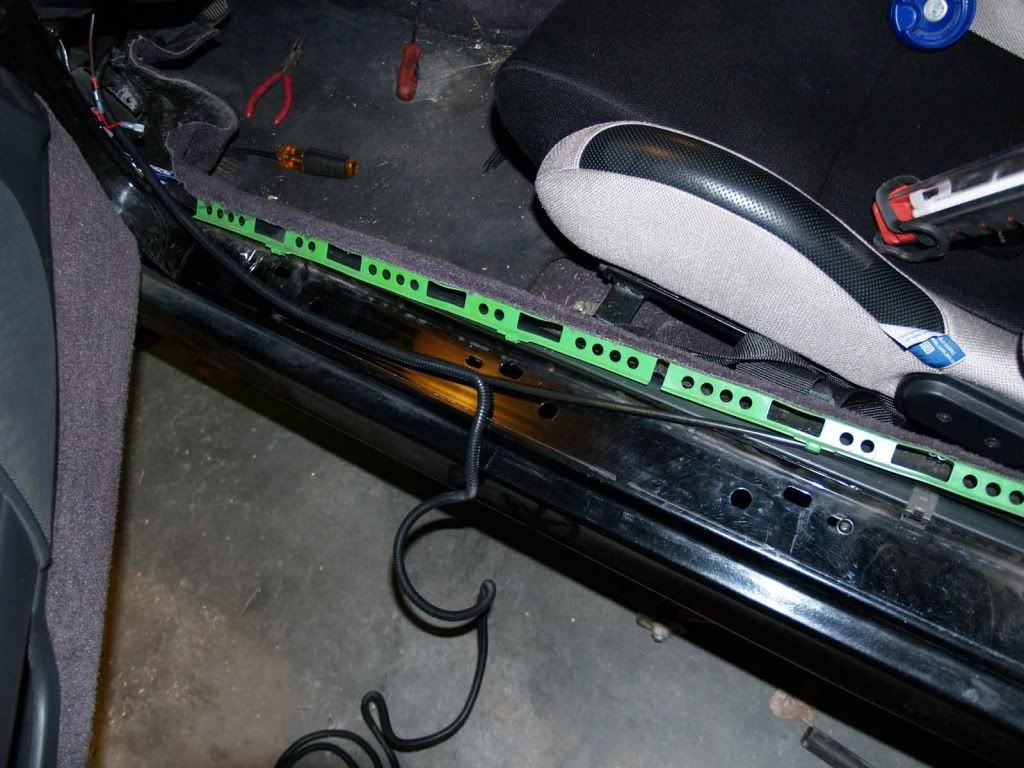

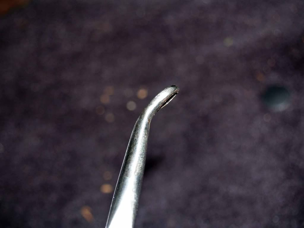

This next series shows how easy it was to remove the rear carpet with the right tool.

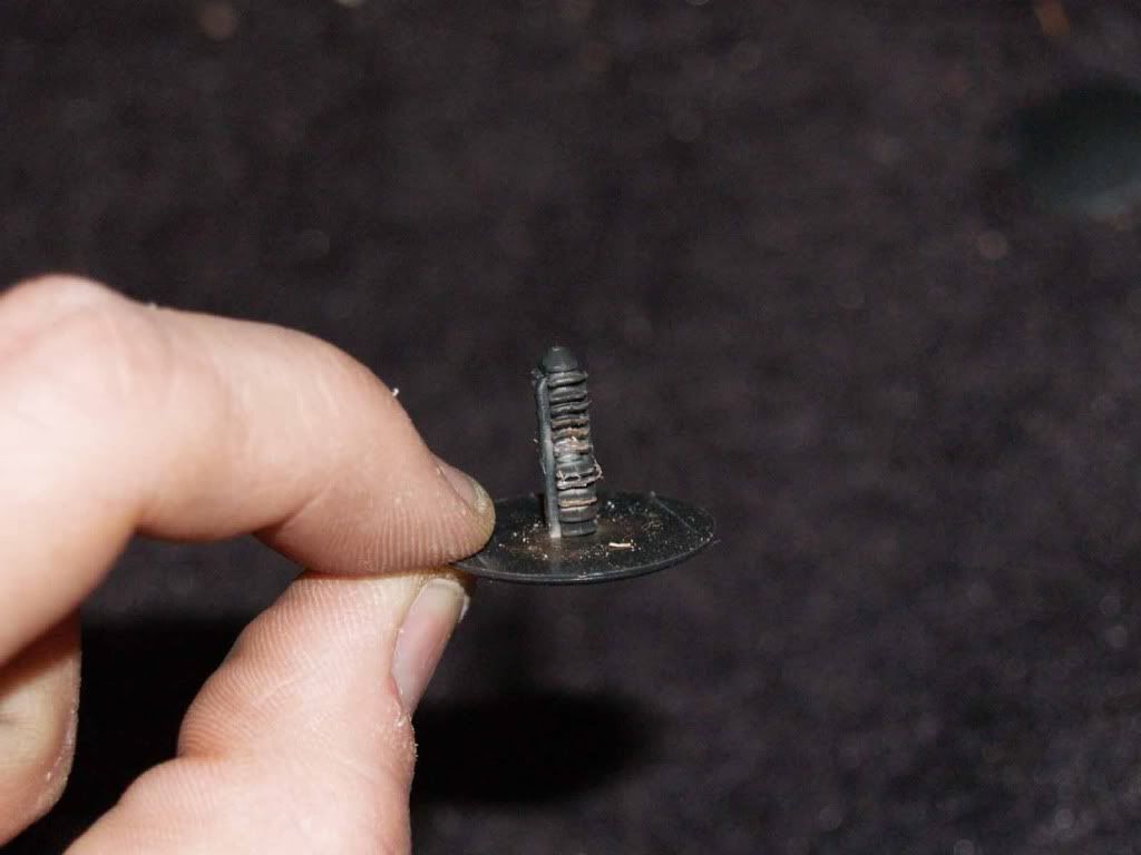

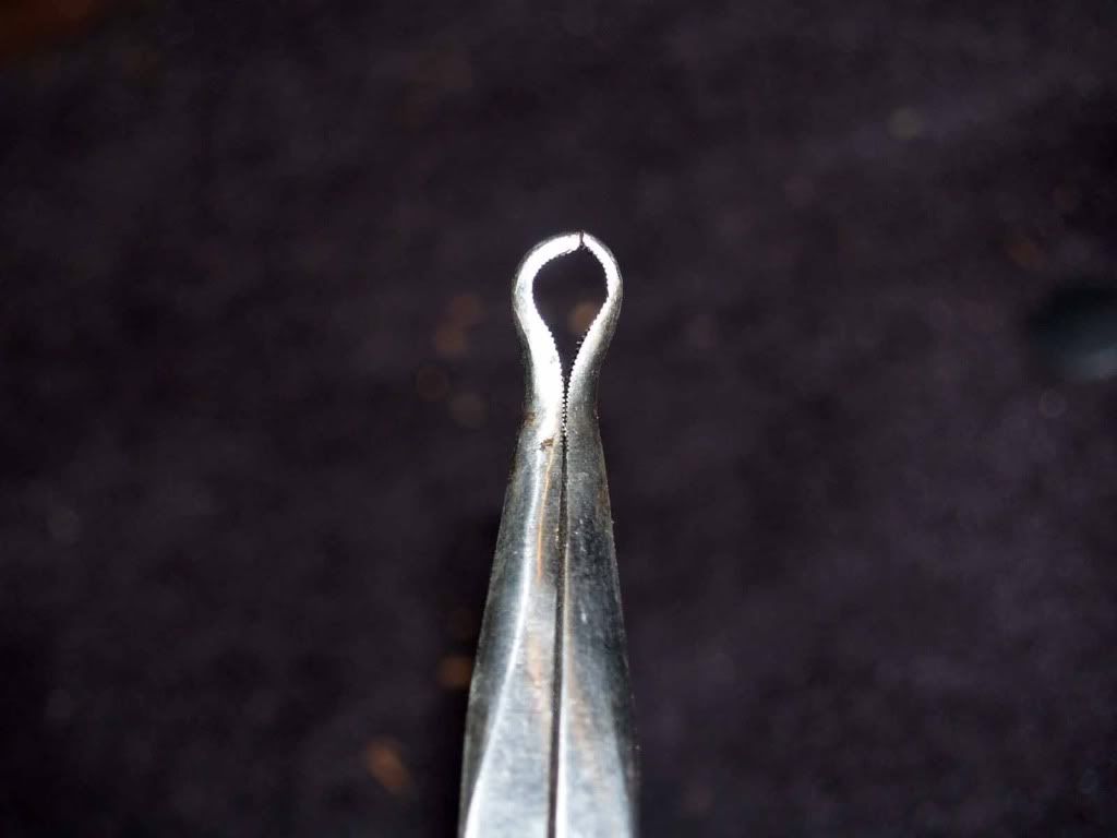

You don't want to break these push in washer retainer thingies...
Hose Pliers...
It works on the ones at the top of the seat too
