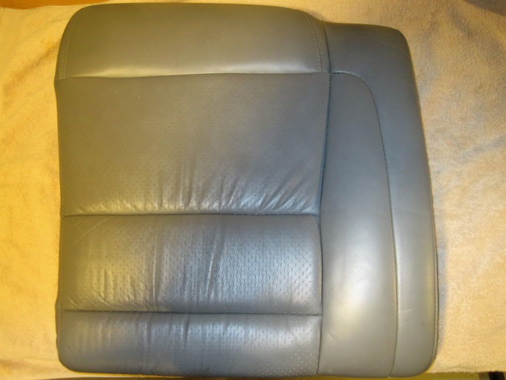

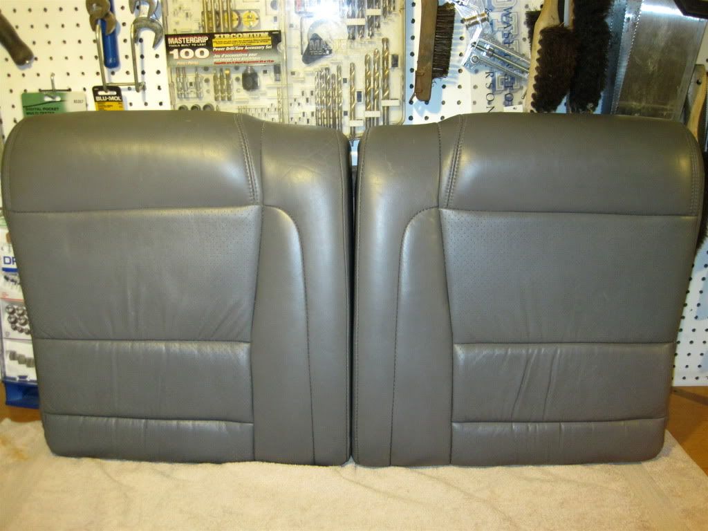

I've always wanted to re-upholster the seats; but, I have lines on a stock set that are in great shape.
Lol. I learned that one year when someone was spraying a wood fence near my car (before I had the Supra). I had drops of varnish on it for at least a year! :: angry :: Anyhow, the rotor hats will look sweet in black. :thumbup:
Yeah re-upholstering them would be a little costly. I've looked into that already. The replacements look like new. Great find.

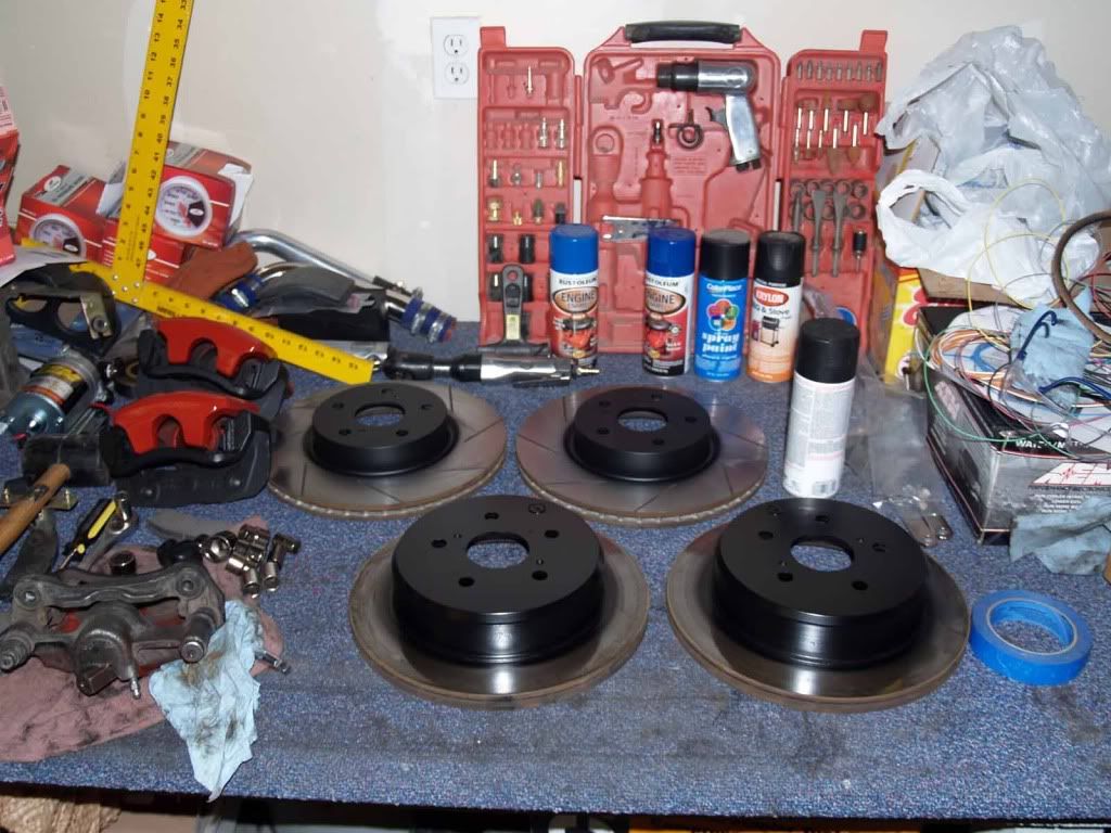

No wind today so I got my rotors painted. The bad thing is that I ran out of Flat Black. I went ahead and hit the rears with a couple coats of Semi-Gloss and will finish them up with the Flat Black tomorrow.

Thanks! Yeah, I thought they turned out pretty good too. I picked up some more Flat Black today. They look much better now! :)

Today I got the two rears painted flat black and also the last caliper. The rotors look much better in Flat!

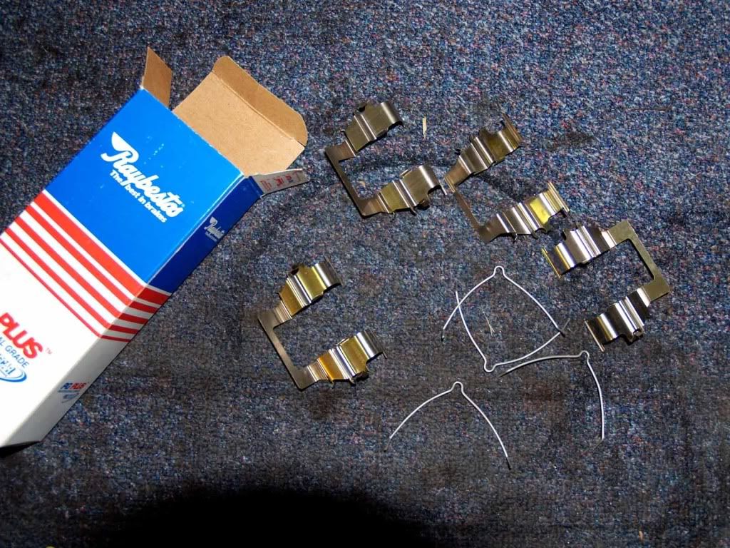

And one of two shipments arrived today. This is the Front Brake Hardware Kit. The rears should be here tomorrow.

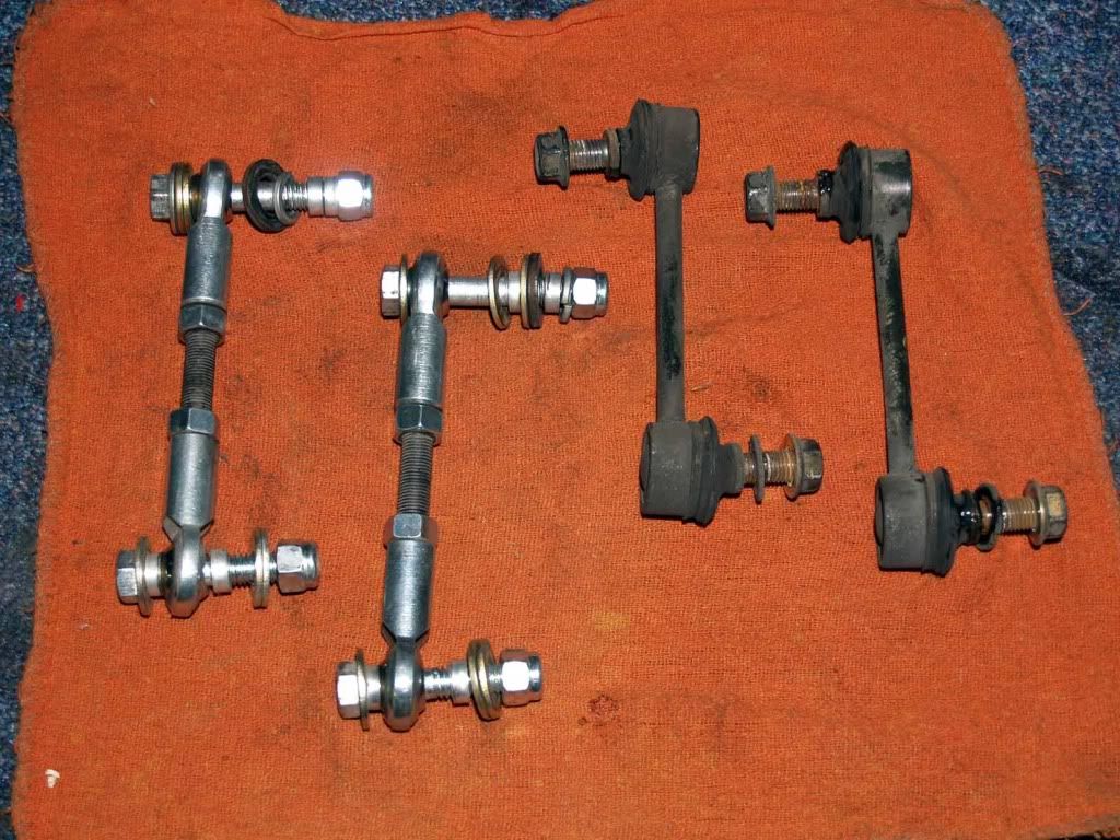

Ok. Out with the stock end links and in with mine. After pricing out end links, I decided to make my own! I made four altogether.
(I actually have enough material left over to make one more set. Maybe even two more. In case anyone is interested! ;))

Thanks! I cut the spacers out of Aluminum, the washers, nuts/bolts are all SS, and everything is Grade 8.
I can't find my receipts right now so don't hold me to this price; but, I'd sell a set of four for somewhere around $160. If someone is seriously interested, I'll get an exact price.
