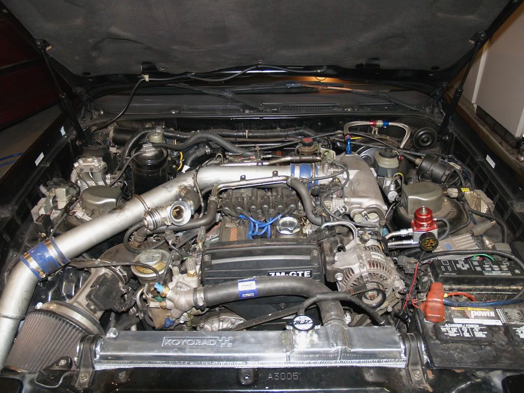

How come you kept the EGR? I would of removed it and used the japanese ECU. You are using a MAFT pro, so you could have tuned it to where you would have lean issues. The EGR to me just is an eye sore. I know I might get flammed for this but why not remove it if you have the option to tune the car to compensate for it.
The polishing work looks good though. So you sanded it smooth with 1500 grit and then 2000 grit and then hit it with polish? Was it wet sanded? What polish did you use?
Where did you get your seats? Sparco or are is the harness just a Sparco one?
Leaving the EGR is cheap insurance. That outweighs the cluttered look. ;)
The polishing work was all done 'Dry'. The grit progression went like this: 400>800>1000>1500>2000>Polish. I used only one stage of polish. The Rouge.
The 1500>2000>Polish was only done to the rear alternator plate because it is REALLY smooth to begin with.
Yes, those are Sparco seats and Harnesses. They came with the car. I was amazed at how comfortable they are!

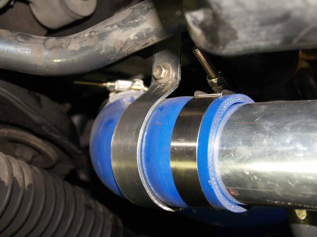

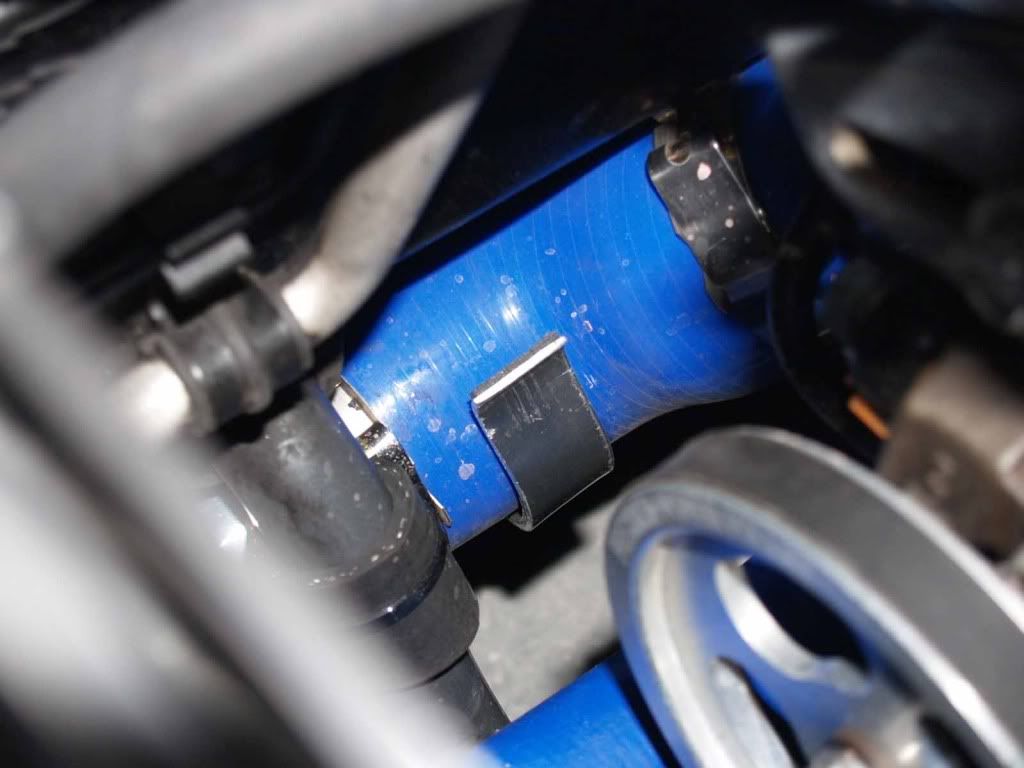

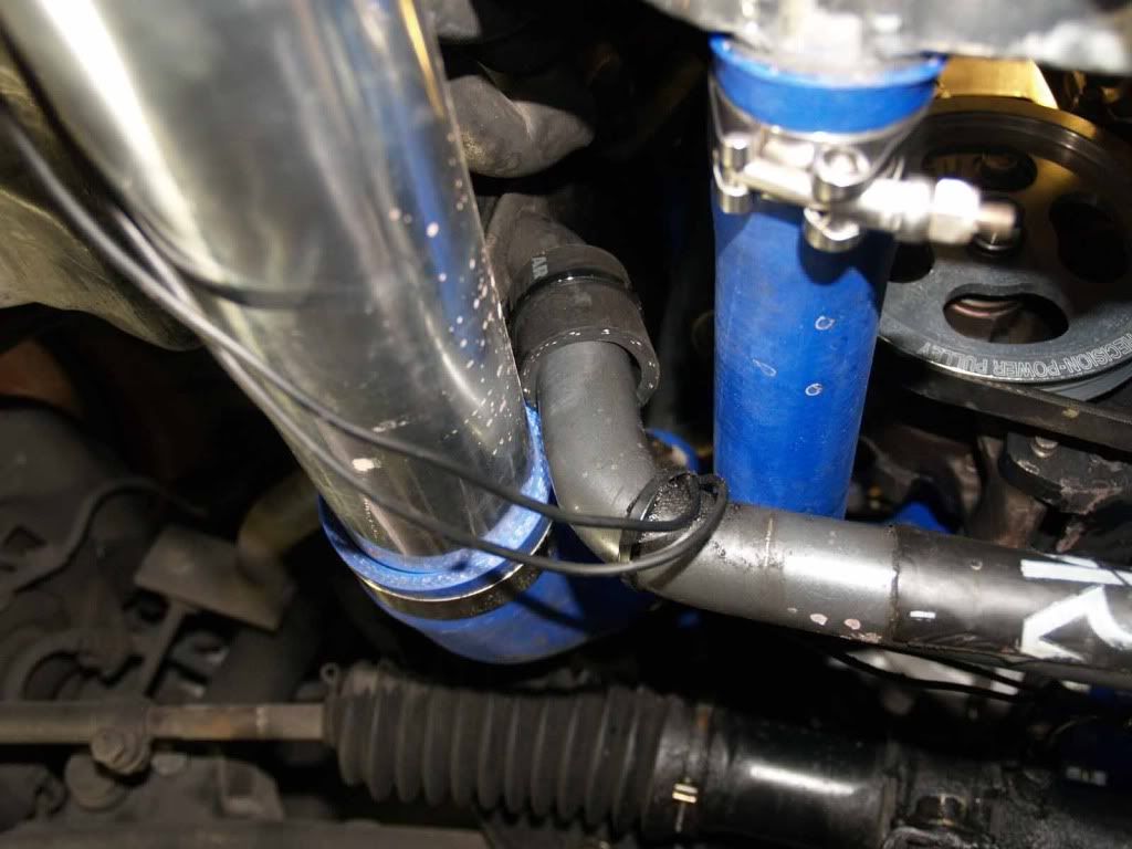

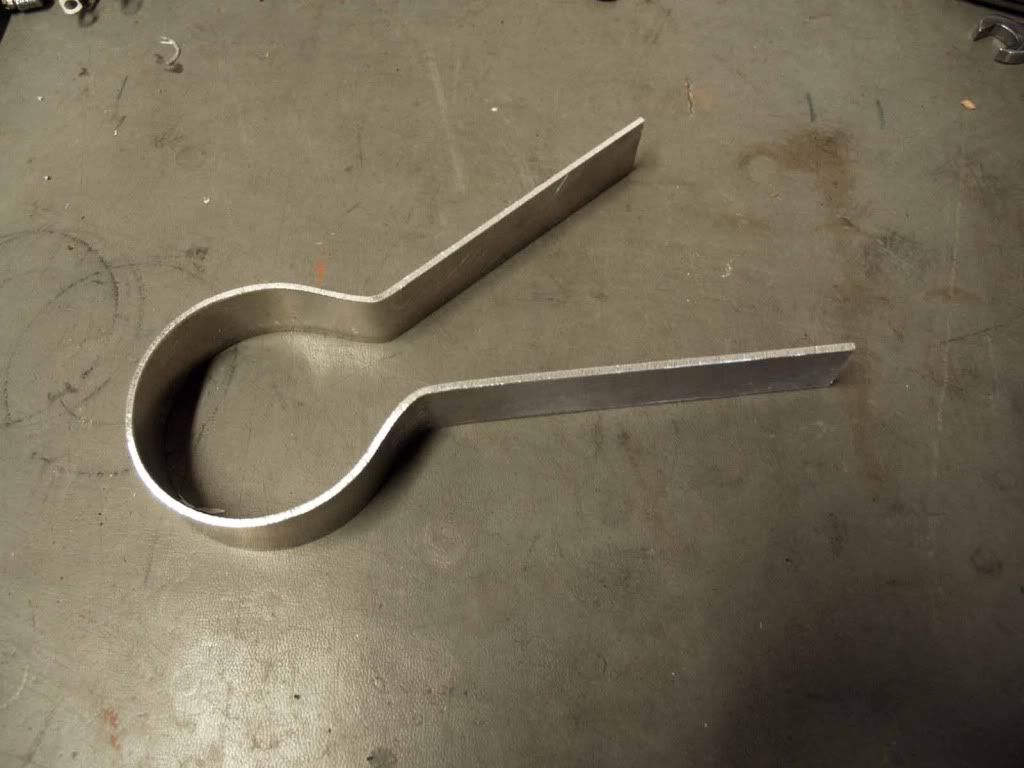

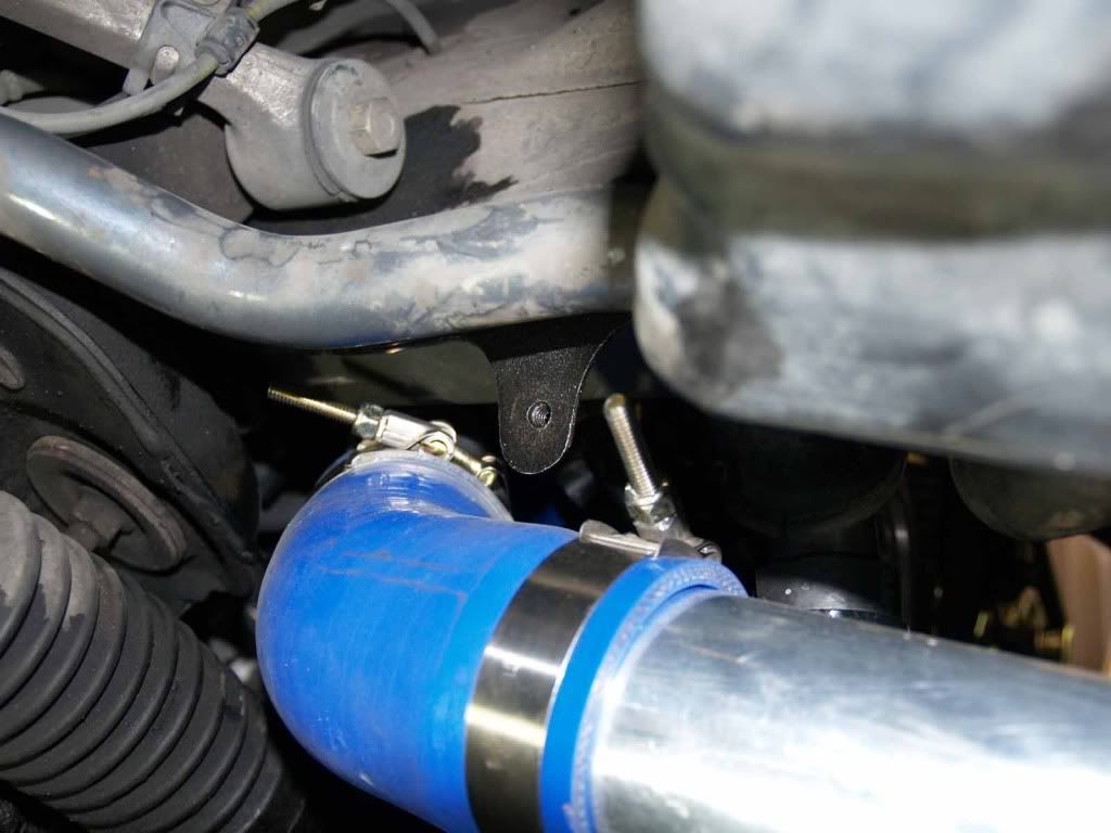

So, I have a few rattles to take care of. Here's one. The IC pipe is hitting the sway bar.

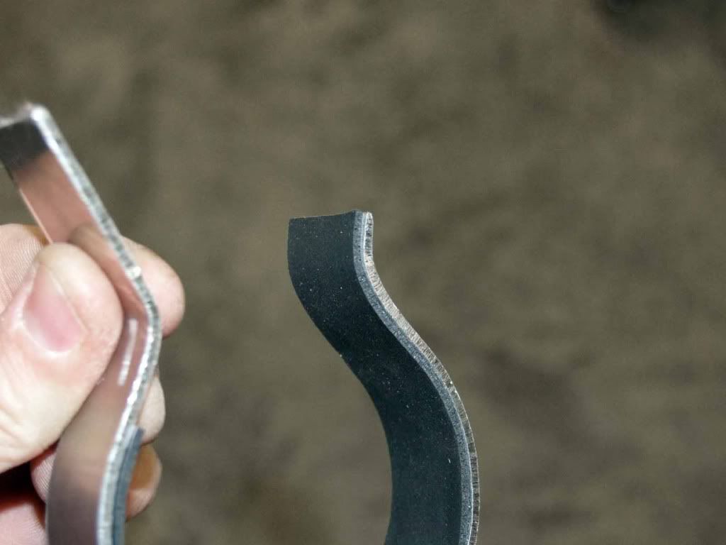

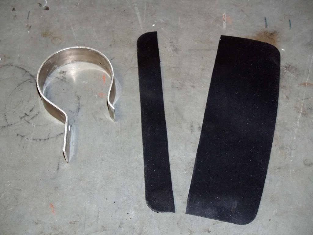

And on to the solution... Here's some 1/8" aluminum bar stock that has been bent to accommodate my 2.5" IC pipe.
The plan is to use the conveniently located threaded tab just above the coupler. :)

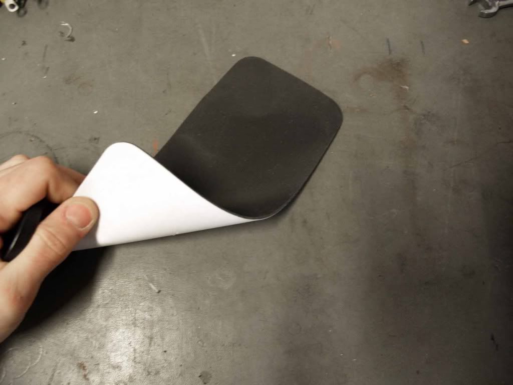

Here is some single sided sticky foam that I used to line the inside of the brace so it doesn't cut into the coupler.
And here it is all mounted up.
Bottom view...
Top view...

IBoughtASupra;1541817 said:
How did you get to bend the hanger so easily? I would like to do that for my intercooler piping on top by the strut tower.
It's easy to do. All you need is a vice (optional; but, makes it easy) and then bend it around the same size pipe you're wanting to secure. As the Geico commercial says....."Easy squeezy lemon peezy." Or something like that... :)
