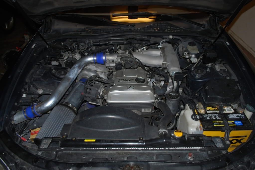

Well guys, things finally have calmed down for me somewhat and I can finally make a post on here. After parting out my MKIII, I came across this car on craigslist, called on it, and picked it up in a couple days. Turned out the car was the daily driver for Chris Johnson (from BoostLogic/Performance Motorsports). Here's what it was like the day I got back from Austin with it.
2JZ-GE - TT headgasket, ARP studs - stock otherwise
BL63 NA-T kit
BL intercooler kit
BL built N/A auto
Re-stalled torque converter
1 of 3 BL SC300 Exhaust systems
AEM EMS
HKS DLI
MKIV TT Brakes F&R
MKIV Struts/Eibachs
MKIV Sway Bars
MKIV Front seats
MKIV Steering wheel
18" SSR Wheels

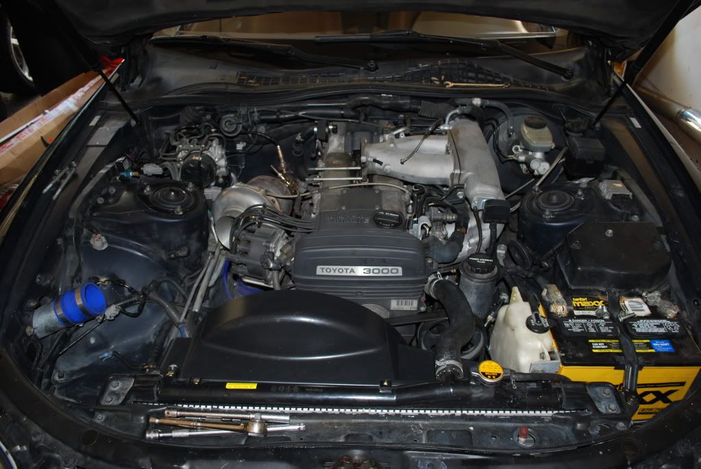

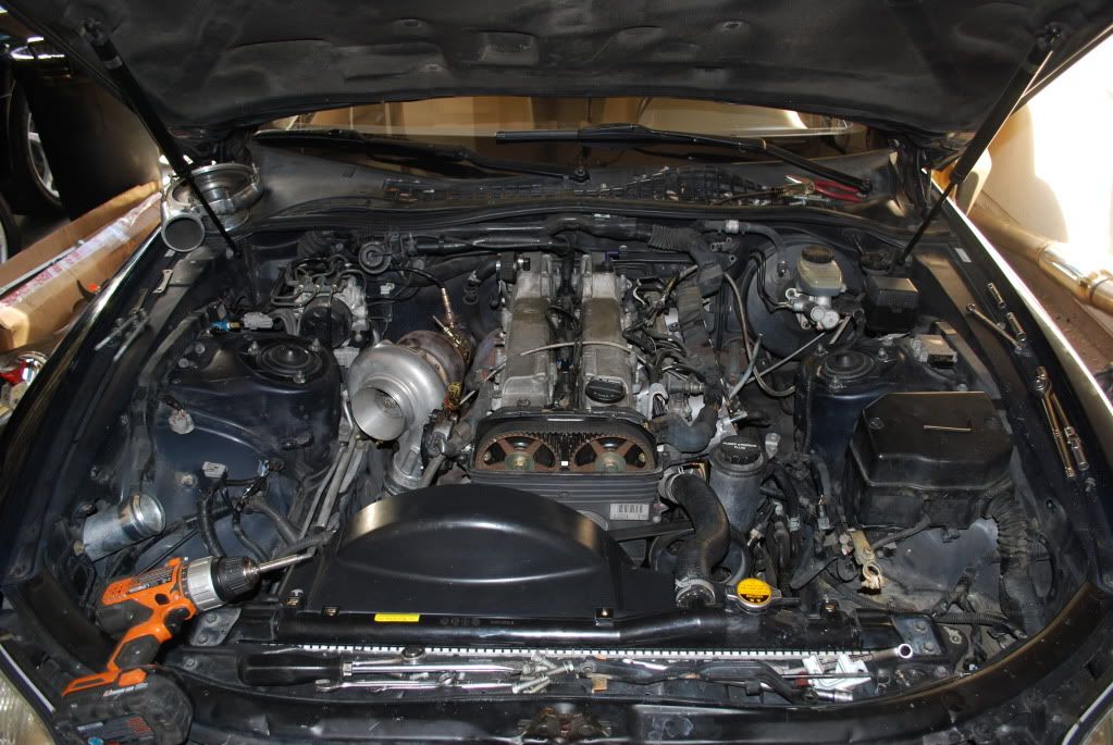

Didn't really do much for a while on it, just a tune up for the first month. Then the built auto setup was killing me (or so I thought) on gas mileage. So I bought a W58 swap from a guy in Houston, and was planning on running it with the boost controller turned out.
But, about 4 days after picking that up, I was catching up with a friend at his Importing company, and ya, ran across a Soarer 1JZ/R154 setup. Bought it on the spot.
Swapped that in and put the 19's off of my brothers 98 Supra on the car.
Also swapped out the 4-spoke style wheel, for the 3-spoke 98 Style out of my MKIII
Took it to the Texas Supras May Meet and tossed it on the dyno, made 366whp @ 11psi (found out I did this on a stock N/A fuel pump, not a walbro as I had been told)

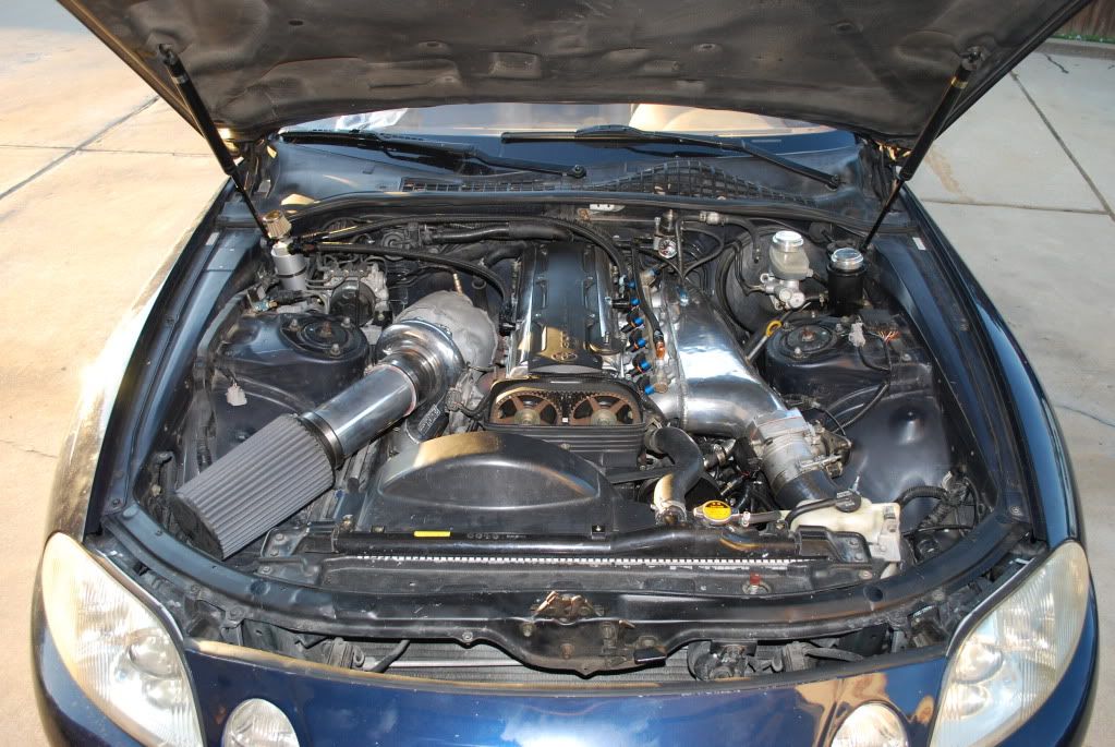

Here's some of what I've been doing before leaving for SoCal.

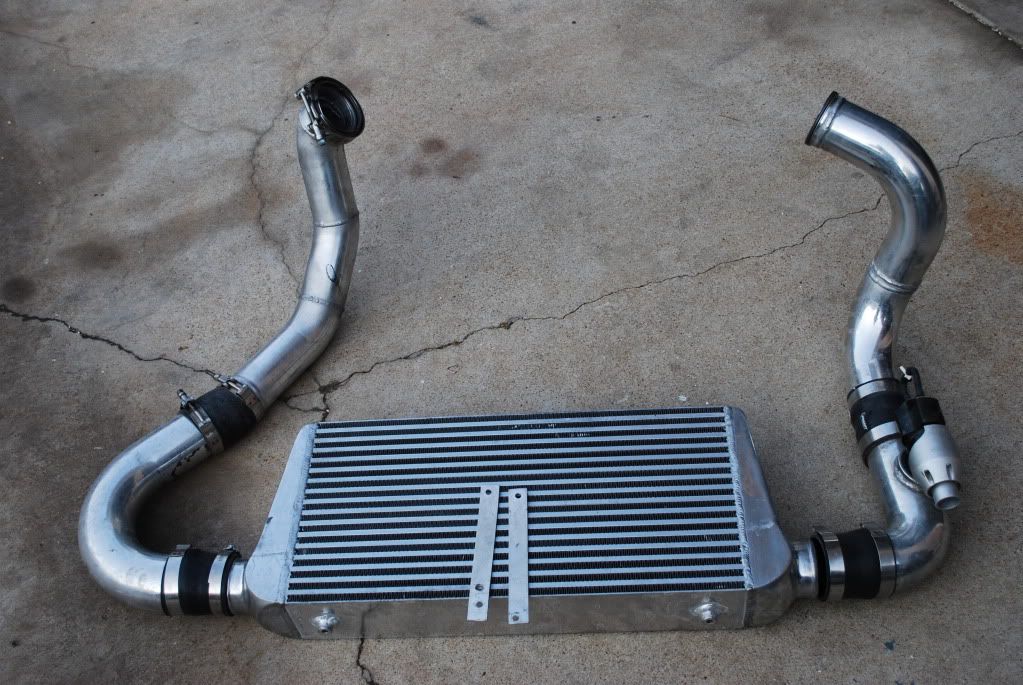

Took off the BL 750 I/C Kit
Replaced it with this (took quite a bit of modifying) its the I/C setup off my brothers 98

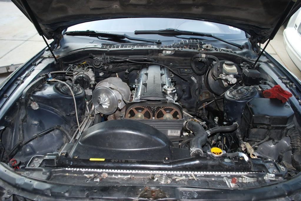

Also doing up alot of changes to the engine
Billet 6765 DBB
VVTi Coils w/7M CPS
GTE Valve Covers
FFIM/Q45 TB
880cc injectors
Bosch 044 Fuel Pump

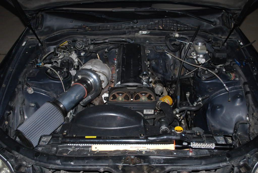

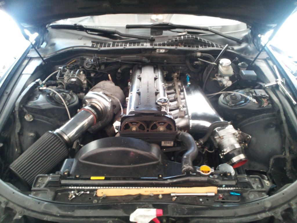

Havent updated this in a while.
Been driving it around on the new setup for a while now
only at 7.5psi on the wastegate currently, but still runs like a bat out of hell. Just ordered cams from DM, so those go in next weekend. Car even gets better gas mileage now.

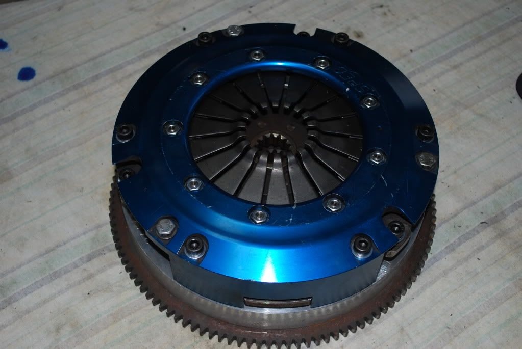

Also got a new piece for what goes in to the car in a month. Spec Super Twin disk for the V160 swap
