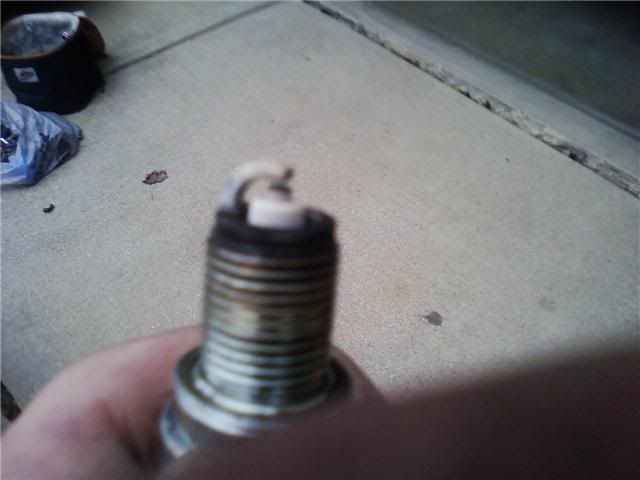

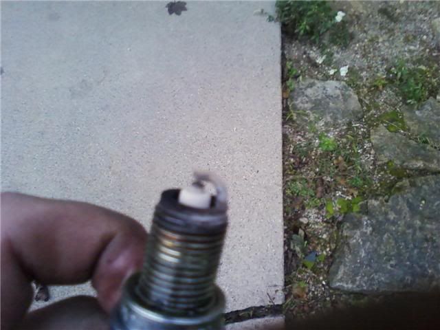

Heres what spark plug #1 looks like, this is the cylinder that i cant feel a pulse from the injector. Tell me what you think.
Supracentral
10,542
11
Does your camera have a macro feature?
Your pic is focused on the ground, not the plug - I'd like to see a clearer image.
