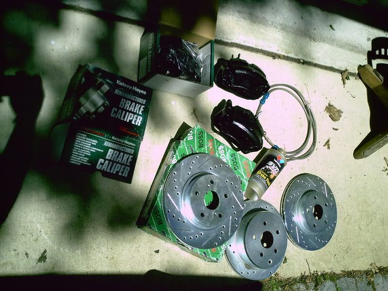

Here is what I did on my brakes on my 87 Turbo Supra.
- f/r new brake pads
- new Valvoline synpower brake fluid
- Goodridge f/r SS brake lines
- f/r new brake calipers
- f/r drilled slotted rotors(even though OEM rotors will do the job)
- new OEM banjo bolts and washers
and the car stops GREAT!!!
As far as your problem with the dirty fluid, check the ring/ cap on the brake fluid reservoir because most likely it is not sealing like it should and you are getting moisture/ water in your fluid.
