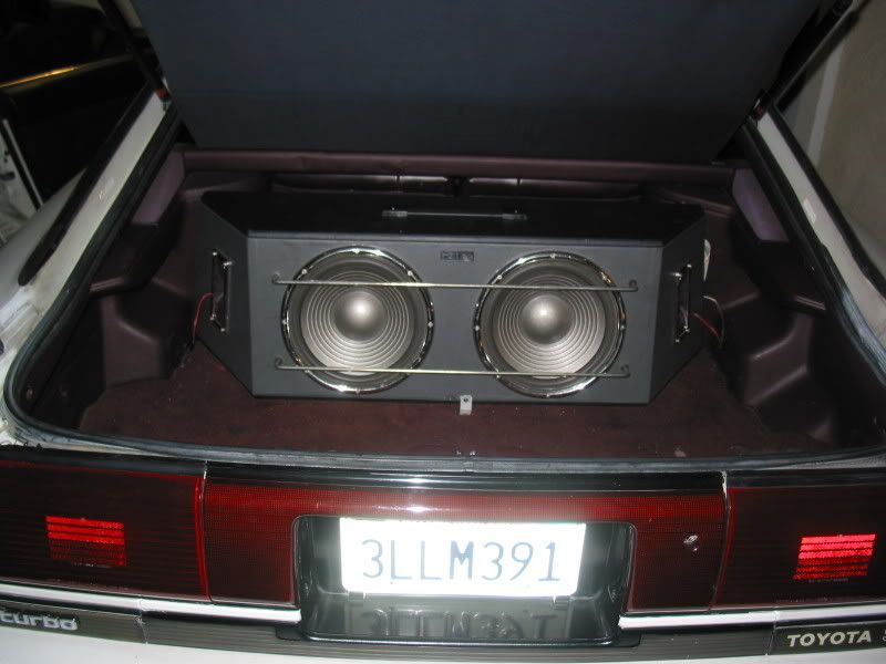

BTW...the Bose speakers I used were rated at "4-8ohms". Hmmm...
Here are my subs...lol.

Creative setup dude, I give you props for trying something like that and setting it up to your liking.
FYI: When Bose states a "4-8Ohm" range, their speakers are actually 6Ohms each. Most current home theatre amplifiers are intended for 8Ohm loads, and the 2Ohm difference is usually not enough to cause a problem (although it can on finicky models). It will usually draw a bit more power out of those amps as well...
As for your car setup; your headunit is rated at 4Ohm loads, so running the 6Ohm load you're actually losing about a quarter of your headunits rated power... This will not hurt your system at all, so no worries there, but have you noticed that you have to turn your volume higher to reach your desired listening level?
Still one of the coolest things I've seen done for sake of creativity and motivation :icon_bigg :cool:
