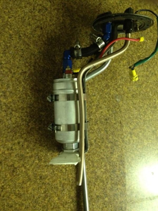

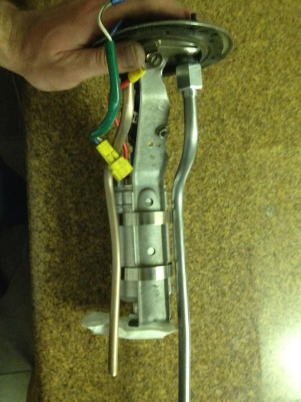

Im running a 044 in tank and an 044 inline

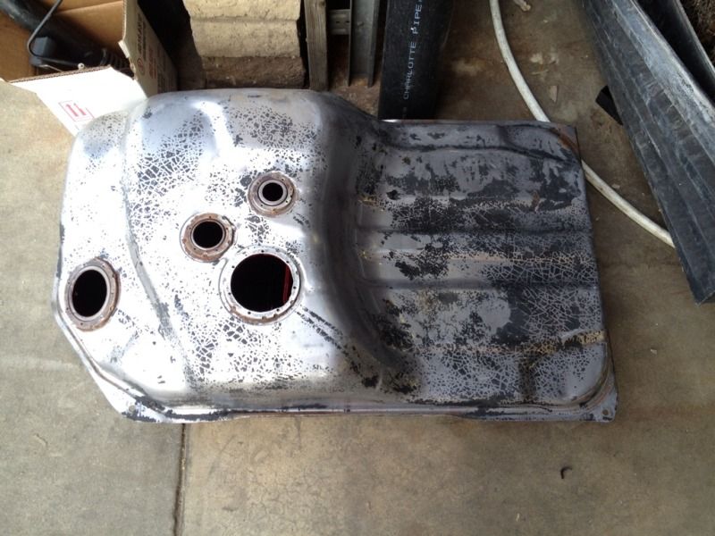

The intank was tricky. I opened up the tank hole as close as I could to the bolt holes to allow more room then ran fitting onto it. Make sure to clean the shit out of the tank to get all the metal shavings out:
IM running e85 so I made all the lines hard SS tubing. Has the return as well as the -8 pickup for the second pump:
zoom in you can see how I opened it larger:

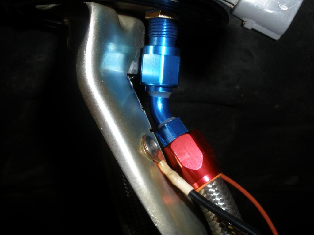

The feed was changes to have an immediate 45 come off the pump so it was easier and hugged the bracket more

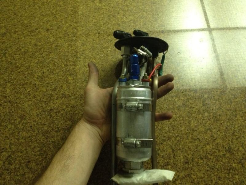

I'm not sure you would prob need to be on race gas, I chose the dual setup for my e85 which is plenty for the 700rwhp mark I want.
I run the one intank all the time to keep fuel cool.
I ran the second inline and its triggered at 10psi.
I made 508rwhp at my base boost so I haven't pushed this setup at all. But I still love it, drives and sounds like stock

You can always do the "Ship In a Bottle" thing and not have to open up the hole, this is how I install the 2x 400's in my Surge tank, connect all the wiring/hoses but don't put the clamps on, lower it all into the tank and wiggle the parts in then do the clamps up.
Albert
May 13, 2009
1,710
Tempe, AZ
That's how I did it before I opened it up. It was a pita so I opened it up so I can install it all and lower it In
