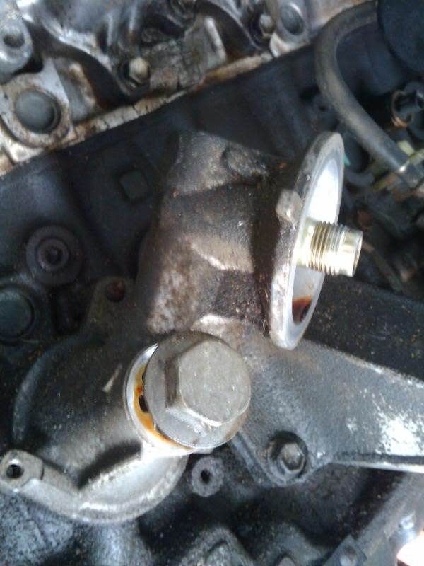

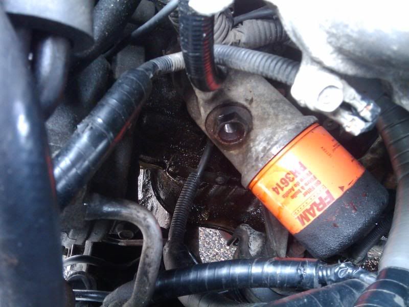

Here are some pics of my install on my 92 SC300 5spd:
Oil Feed tap location

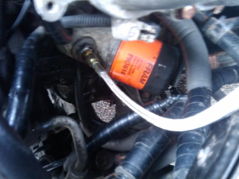

please tell me you've secured the fliter better than that..!!

The filter will be secured better. I forgot to clamp it. As far as tranny goes I'm hoping to keep the w58 as long as possible.

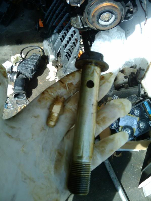

couple questions. can you elaborate on your oil feed tap location? i dont see an oil feed for the turbo. also what did you do for the drain. and another thing. i see i/c. pipes, turbo, etc.. but what are you doing for fuel? i dont see any sort of fuel management.

Well thanks for all the positive feedback guys. Much appreciated. As far as the oil tap I had the bolt for the oil filter housing drilled and tapped for an npt fitting. For the oil drain I used -8 se tainless braided hose with an oil drain flange that I had made locally.

Here are some pics of the oil feed tap:
