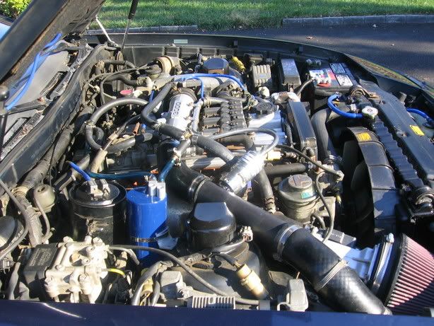

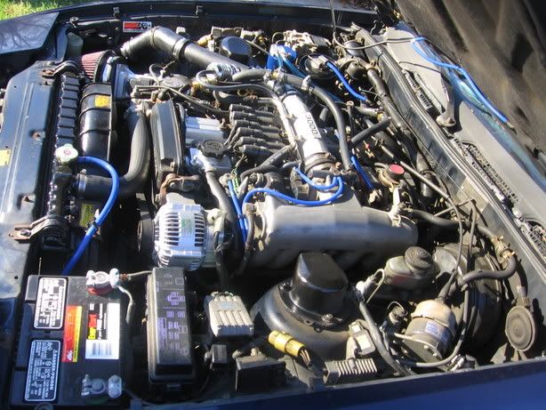

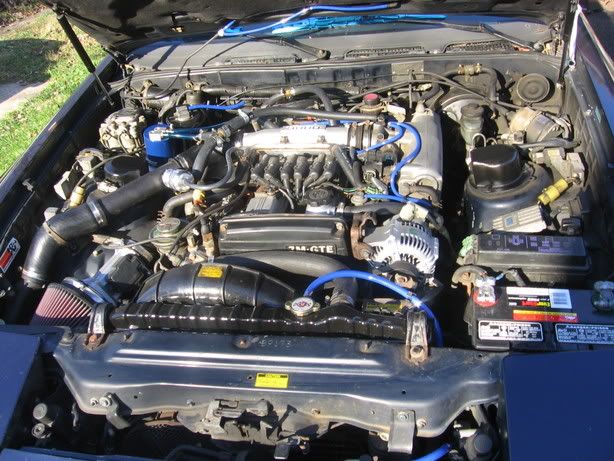

Hey installed a turbo xs type h bov, and a catch can and now i get a blueish white smoke out exhaust after and boost, or somewhat heavy acceleration. Anyone help diagnose what problem may be? Heres setup
-CATCH CAN is set up: Each valve cover has a 1/2 inch hose coming off which join at a "T" where the 3rd connector has a hose that connects to catch can inlet, the outlet goes out to accordian hose. Throttle body part is capped off.
-BOV: Attached to a pipe that replaces the (plastic)stock flat intercooler pipe, capped off 3000 pipe where stock bov conected, and capped off the accordian where stock BOV went down to.
Hopefully its not turbo going (stock turbo, with 167k+), but I never had this problem before install. So maybe something is cappedo ff that isnt supposed to be, or somethign needs to be? Anyone find out/fix my problem +1, but havent had any luck so far.
Heres pics i took same day after install (i rewired the catch can outlet so that hose going to throttle isnt there anymore)
