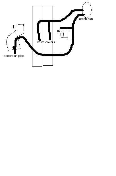

Didn't want to neglect to mention you might need more ventilation, as normally on a fresh rebuild, it's something stupid like this - it's called POSITIVE crankcase ventilation for a reason ;)
Catch can + proper vacuum - or an evacuation system - will do the trick for you.

i've read toooo many posts about how the catchcan should be set-up with the tb nipple plugged. spread the word guys, this is the way to hook up the catch can!!!
Care to explain why/how this works best? I'm just VERY curious.

Marc3's way is the proper way to do it, but what do you guys suggest for those running an FFI with throttle body that has not vacuum port like the stock TB? Mine is set-up like marc's graph, except for the TB port connection.
Thanks
Thanks
that is a very good question, hadn't even thought about that! and i'm installing a ramirez manifold this winter...doh! more custom work!
