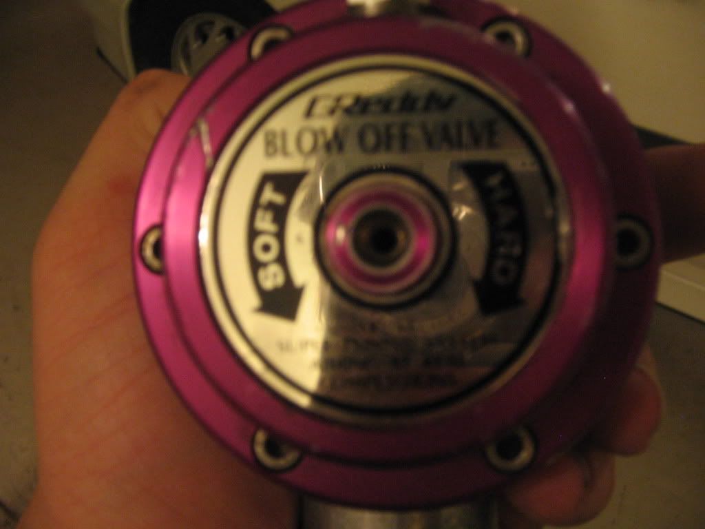

So the adjusting pin on my Greddy Type S broke. Does anybody know how to fix it?
1SLOMK3 New Member Dec 4, 2010 214 0 0 Arizona Oct 8, 2011 #1 So the adjusting pin on my Greddy Type S broke. Does anybody know how to fix it?
Albert Custom CT26, CT12a, CT20 upgrades May 13, 2009 1,710 0 0 Tempe, AZ Oct 8, 2011 #2 Disassemble it. Drill out the top hat and retap it. Add new allthread and 2 nuts. Since toy won't have the Allen key thread anymore
te72 Classifieds Moderator Staff member Mar 26, 2006 6,602 2 36 40 WHYoming Oct 10, 2011 #3 How did it break, in the middle of the screw? Looks almost like there is still a place to stick the allen key in there...
