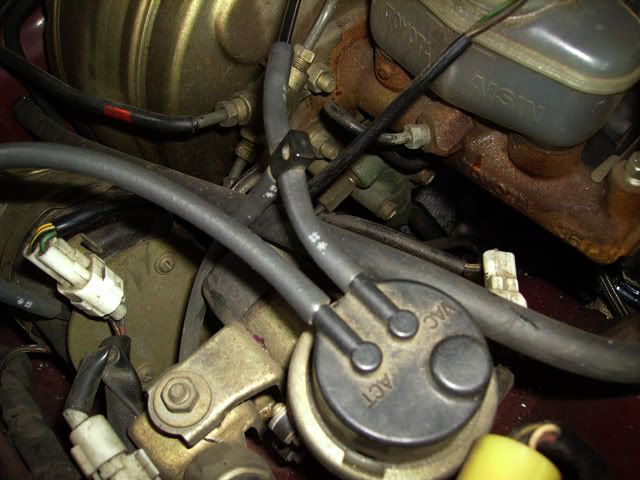

Now my first question is about the vac source - I currently have it set up like this:
and the vac line on the other end ends up going all the way to the wastegate, with other things T'd into it.
Is this bad?

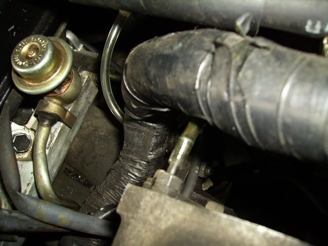

Also, I'm not using the vac port on the bottom of the accordian hose - can I connect the bov to that?
![sm_photo_missing.jpg](https://www.supramania.com/images/sm_photo_missing.jpg?old=http%3A%2F%2Fi34.photobucket.com%2Falbums%2Fd145%2Fn13vectorti%2Fconversion%26%2337%3B20photos%2FPICT0370a.jpg)
Is this bad?
