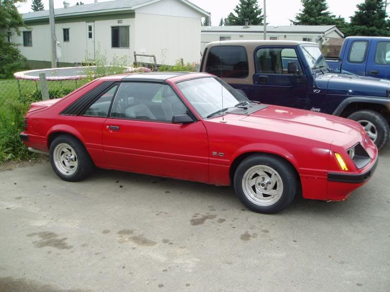

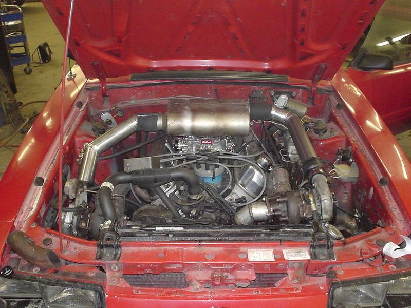

Here is what happened last time I rebuilt an engine that had blow by. after I rebuilt it I got bored grabbed a welder and went to the junkyard. I never even expected it to live past startup. It was in my 1986 mustang. Yes that is a twin turbo blowthrough carb setup and I used my old flowmaster gutted out for a carb hat :naughty:

Draw through is a cheaper way to go but there is the chance of turning the intercooler into a bomb if you have one and it's harder on the turbo. I rebuilt the edelbrock carb to handle the pressure of turbo application and the extra fuel needed so that saved me a lot of expense. I think the total I spent on the diy turbo build was under 700.00 that included the wideband, boost reference FPR, high flow edelbrock race pump, and boost gauge. When I did that build I knew nothing about turbo's. Learned how to weld on that project also. It failed as I knew it would but not in the way I was expecting. One piston had a flaw in it and the skirt cracked right below the oil ring, was the weirdest thing. I originally thought it was detonation but why would that cause the bottom of the piston to break? Also a piece of welding slag went through the intake.
I was pretty bitter about that and dumped the car for a off road rig. In the end I rebuilt it for the guy anyway lol, cool thing was that the company I bought the internals from sent me a replacement piston and rings free of charge. I had a blast building it and what I took away from the experience was worth losing it in the end.

It was pretty quick when I could get the tires to stop spinning. I originally had it as a cruiser so it had 3.73 gears in it and a 5 speed, this equals instant full spool and as such instant wheel spin. I used nitrophyl floats, modified the choke and drilled out the jets. Honestly though I can't remember it all it was a few years ago. Yeah those welds were horrible but they held lol.
link to build, some pics are gone now though. http://www.theturboforums.com/smf/the-turbo-'builds'-board/my-86-twin-turbo-build/
