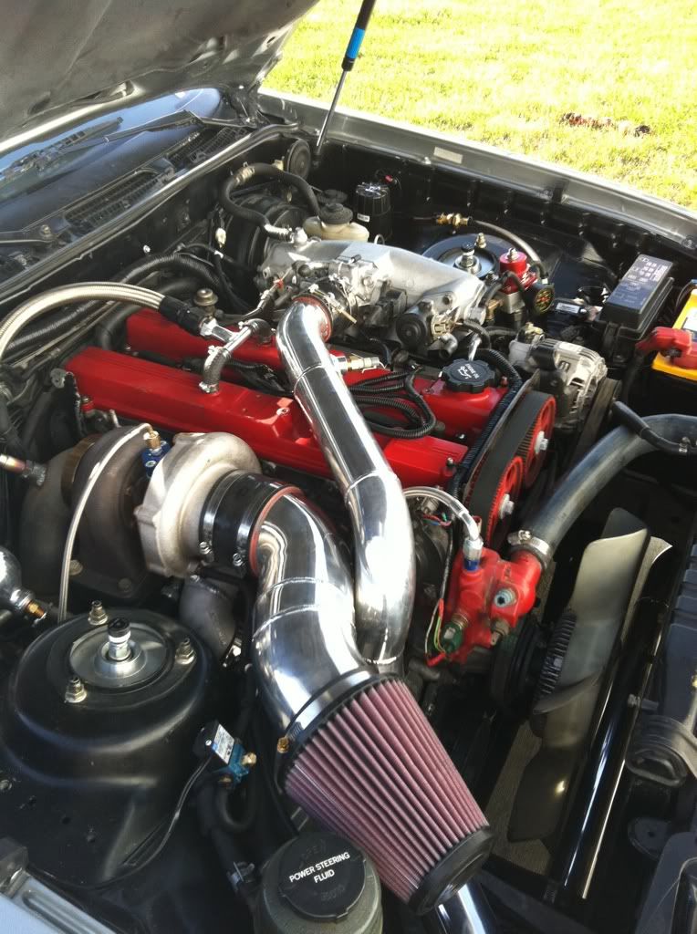

I was messing with pipes the other night and this was all that i could come up with that would clear the hood, etc. Having the turbo 3/4" higher from the QSV really makes things tight above it. But i think it will have to do for now, i dont have the time to make an intake, or funds to buy one.
Cant wait to dyno it and see how this turbo responds!

Couldn't have chosen a hotter/worse path for the charge pipe :(
Would have been better to clock the Comp cover and use a cast 90 bend then come forward....
