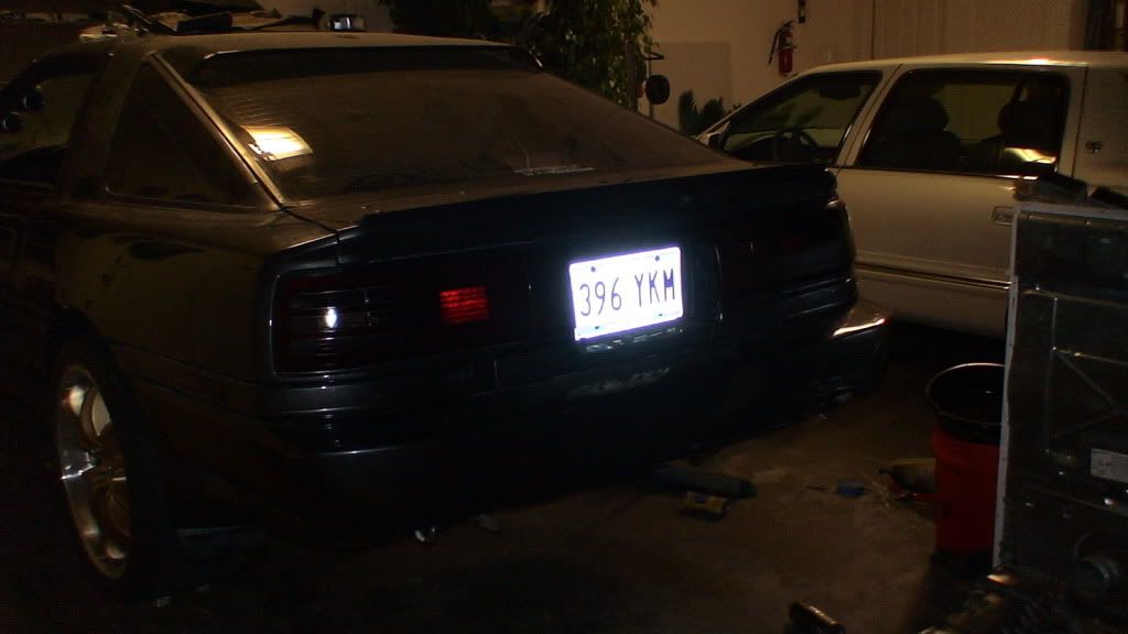

tinted my tails

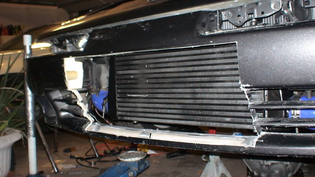

started the work on the front bumper, my head still hurts from the smoke the cutting wheel made

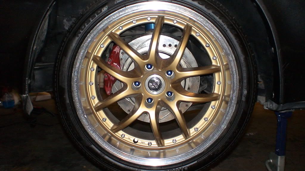

got the new SS spacers on the rear brake setup, either measured them wrong, or i put the pads on the wrong sides of the caliper, the inside pad on the pass side pushes against the rotor. fixing that tomorrow

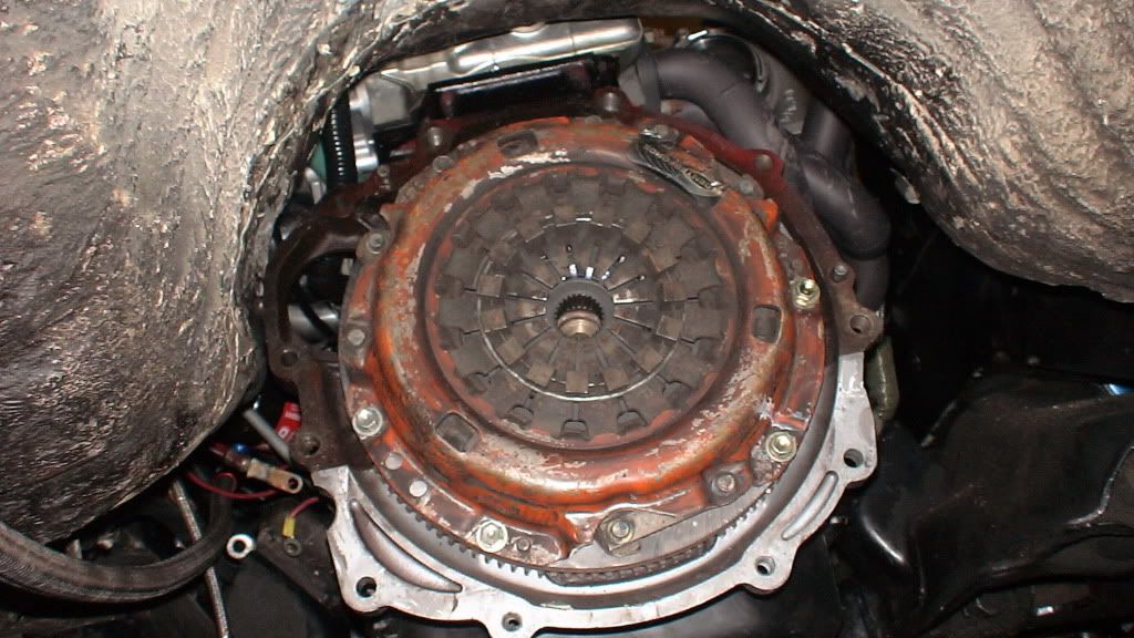

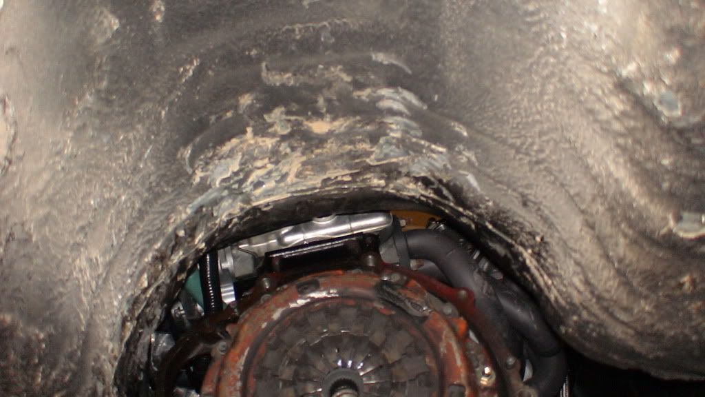

heres the mounted clutch and some of the beating on the trans tunnel, still have more to do, but shoulders hurt

wellllp, nothing much other than i have a new longer input shaft on order from thegearbox.
for anyone considering this transmission, you must either use an LS1 trans or put the LS1 input shaft into an LT1 trans. the LT1 input shaft is too short and will not engage the spline on the clutch disk

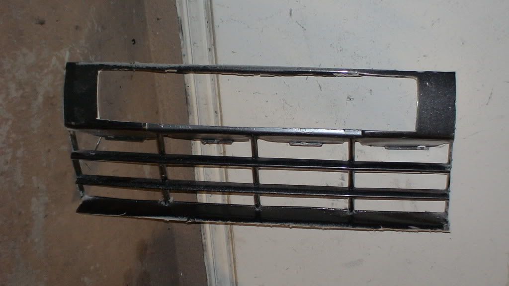

heres the opening on the bumper before any work, plenty of airflow to the intercooler

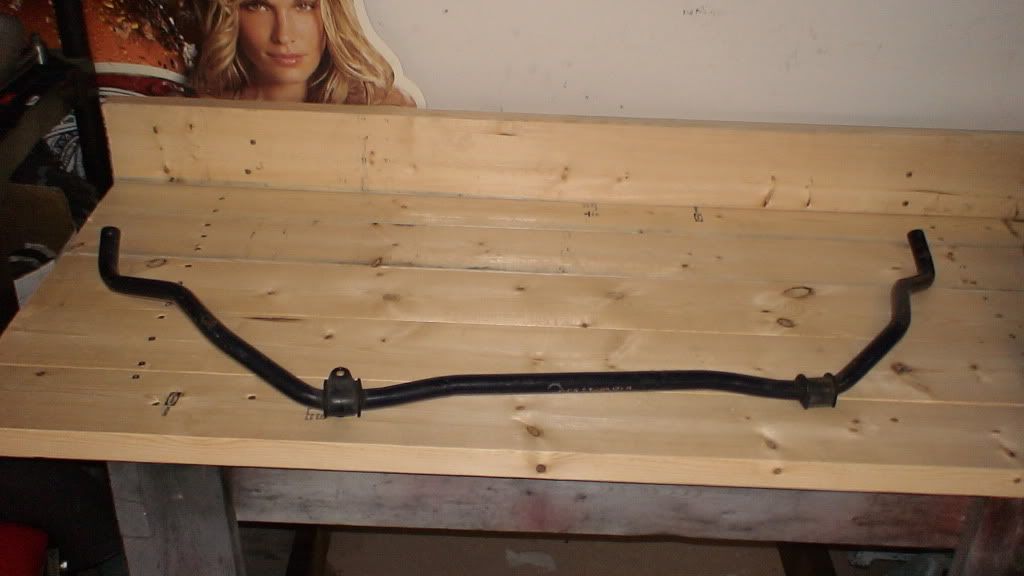

got this for free from a good friend, he said it was ARC, kinda looks like it from the worn label, but i know its bigger than the stock rear sway, just need to figure out what to do for endlinks

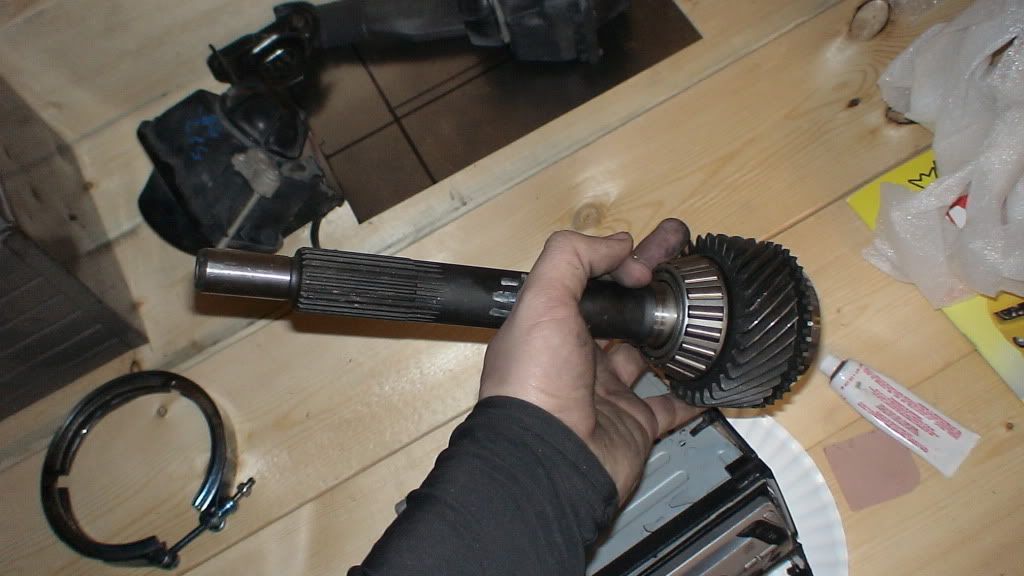

bought a hardened input shaft from a Viper's T56 yesterday, sniped it on ebay for 66 bucks. shouldnt take long to get here since its coming from just north of Austin.

heres the Viper input shaft, this thing is beefy, about twice as heavy as it looks, gonna have to have the end milled down to match the pilot bearing, as well as its a lil too long.

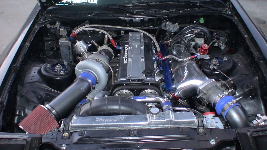

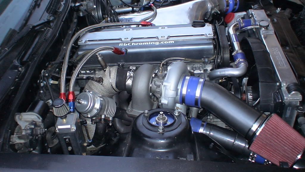

also got the v-band put on the downpipe and got that back on, gonna need some work on the bottom, but that can wait, ill just drive open DP to the exhaust shop when the time comes. from this angle the turbo looks frickin massive, i guess its just the picture, it doesnt look that big in person.
