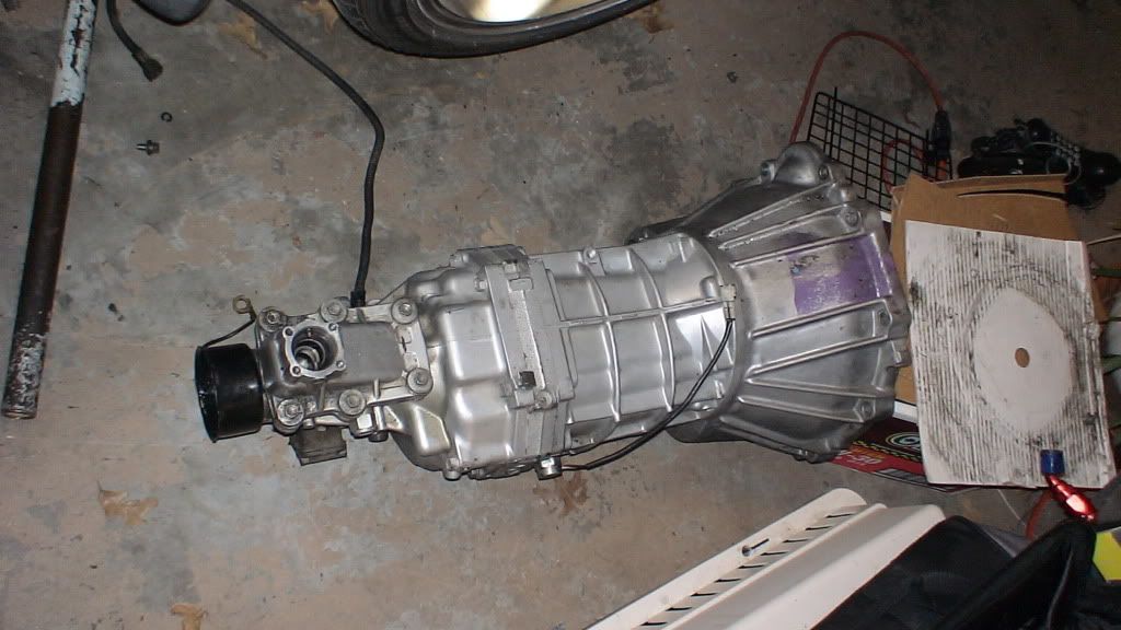

started pulling everything off the car today, trans is ready to come off, just didnt have time today to pull it off.

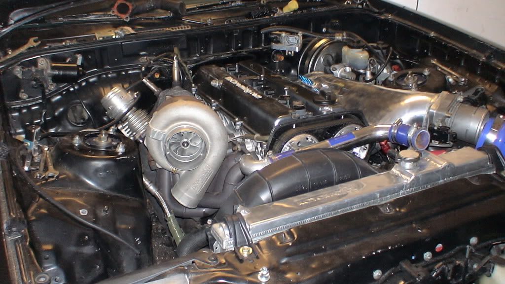

put some VHT high temp paint on the exhaust, make it look a lil better than it did on the car

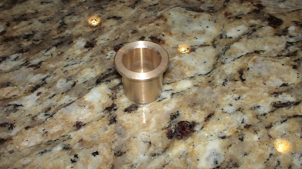

also, couldnt find a pilot bearing with the two sizes, ID for a T56, OD for a JZ crank. ended up with a brass bushing for the LT1, going to take it to my machine shop and have it turned down to match the JZ's crank.

heres a comparison of the driveshafts, hoping it comes out without too much work, T56 looks a little longer, so hopefully it comes out.

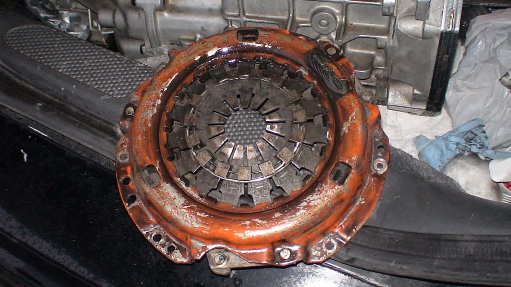

R154 and OS Giken off
after just kind of holding the T56 up in location, shifter wise, it looks like ill need to notch the back of the shifter hole 3/4"-1" to fit the hurst shifter.

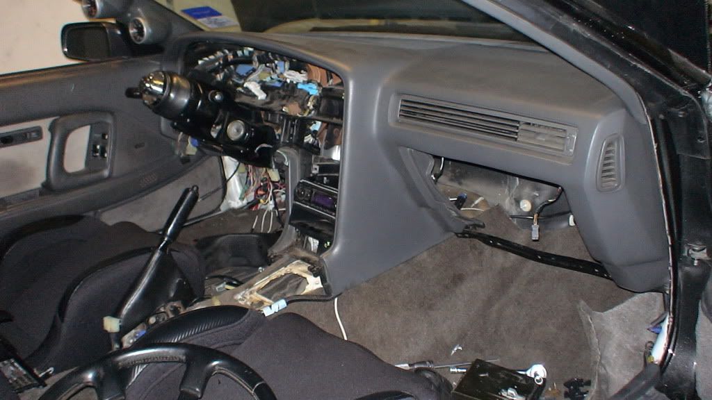

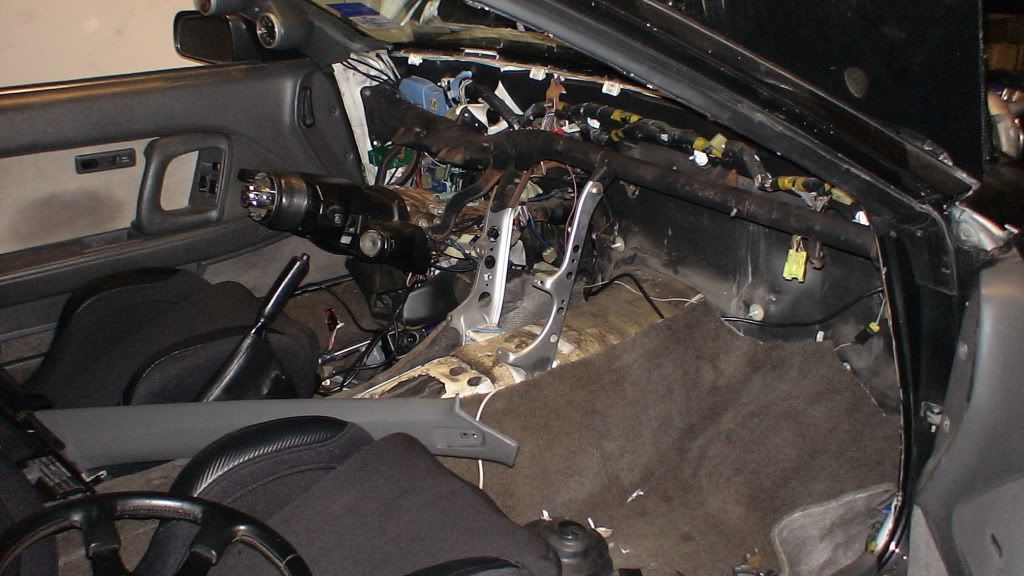

also took out all of the HVAC system, not gonna need it by the time the cars running.
during
after
pilot bushing is at the machinist as of this morning, alot with stock to make the spacers for my rear brake kit.

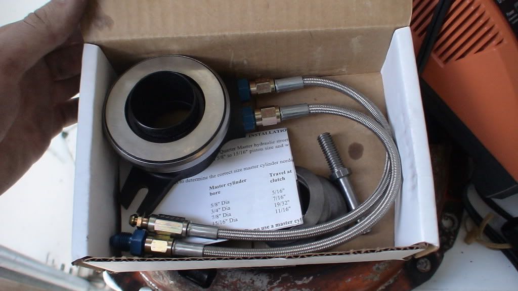

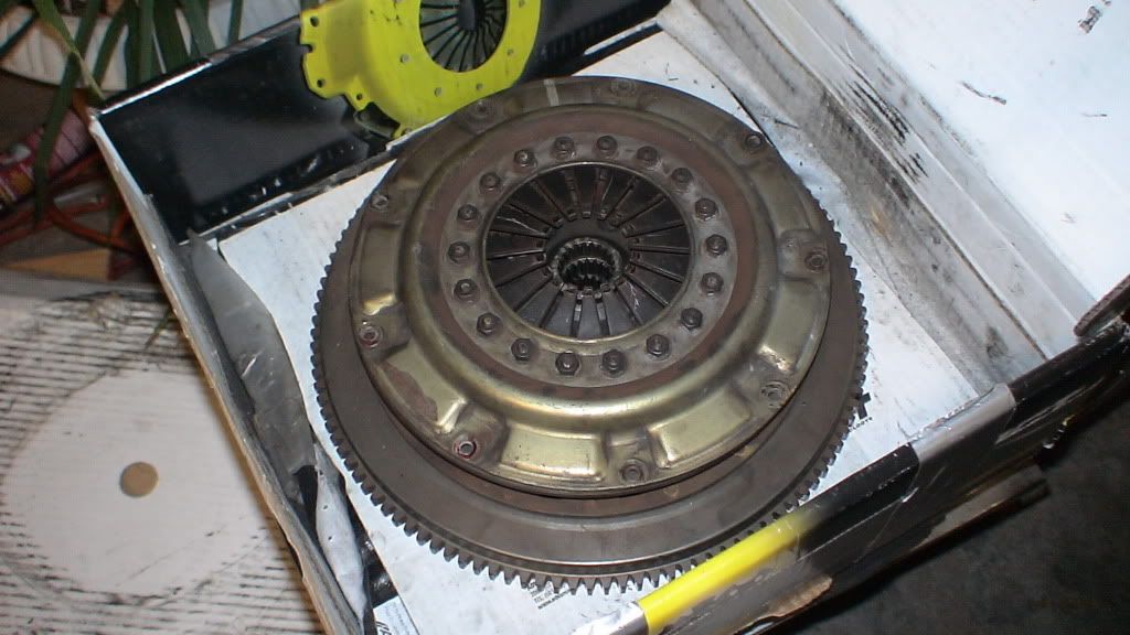

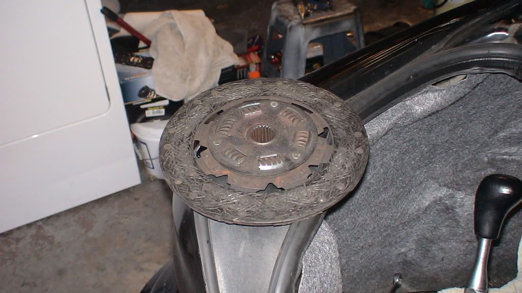

Centerforce clutch
Quartermaster slave cylinder

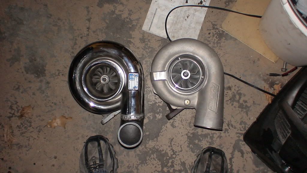

PT76GTS (needs a rebuild and a new wheel, but got it for a friggin steal)
PT76 next to the T88
the turbo will be going to Majestic Turbo in Irving on monday to get rebuilt.

in a couple months, the Trans will be getting built up to Viper specs, and a twin disk will be going in.
