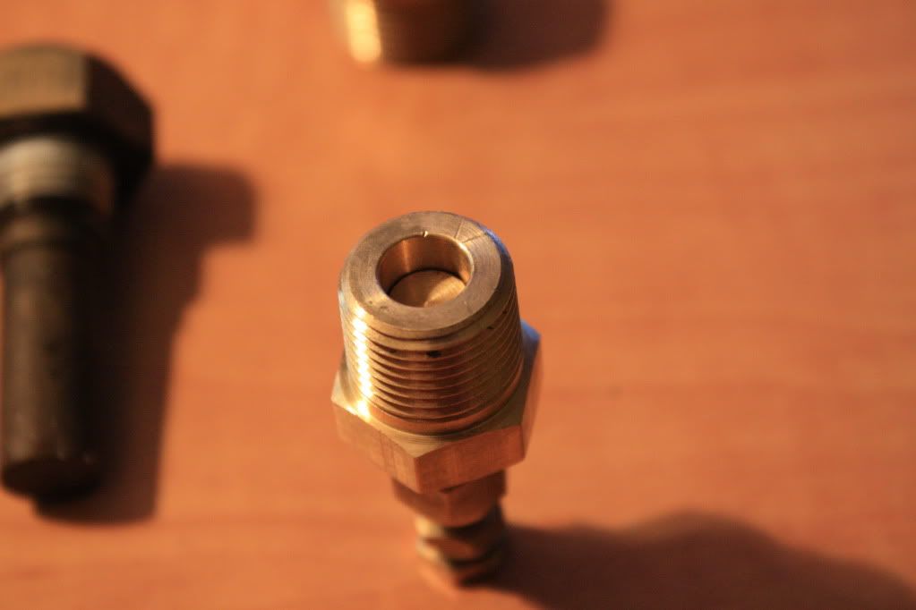

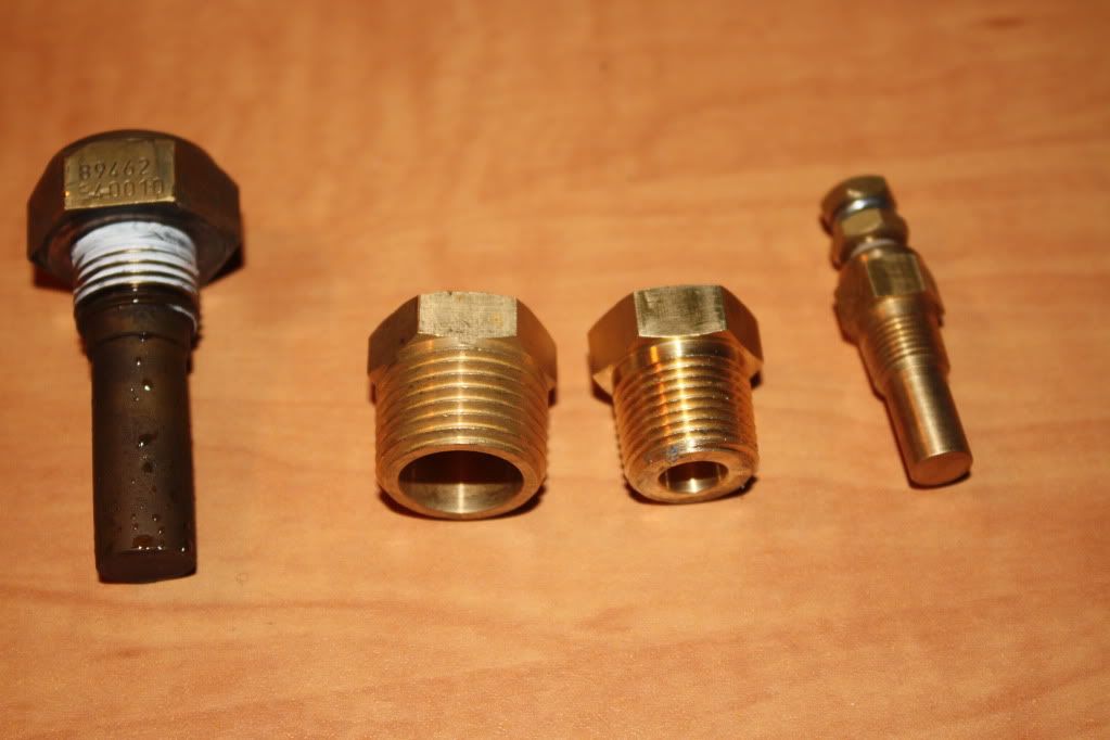

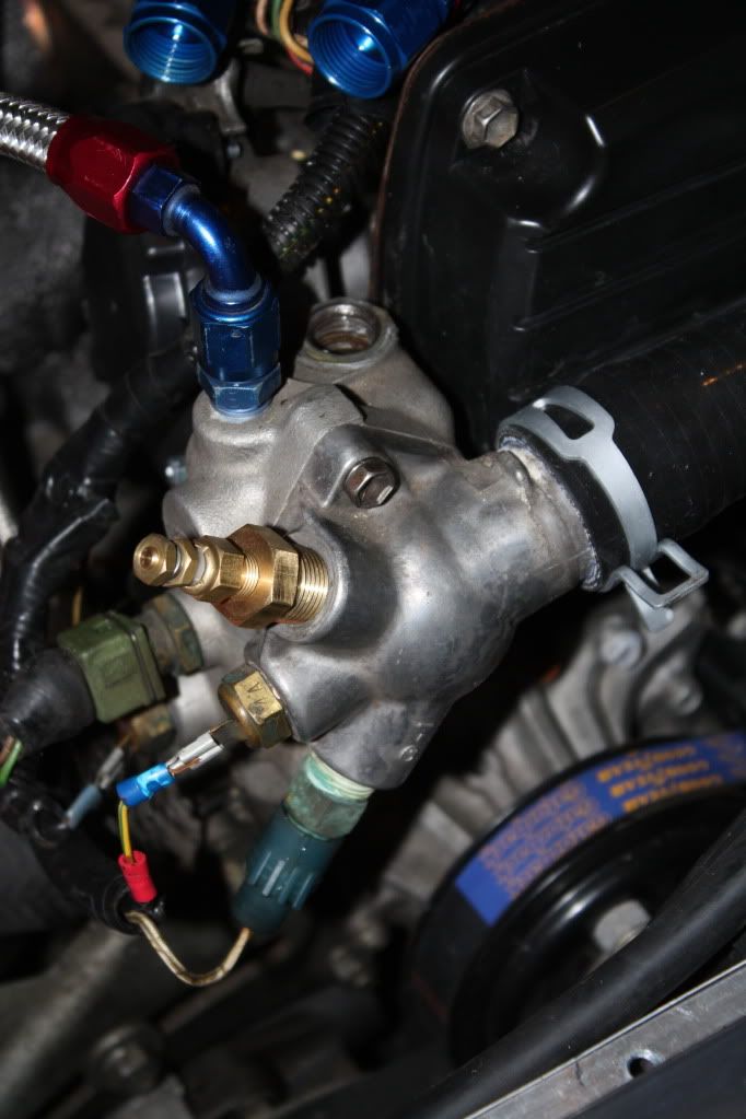

Time to add pictures. I work better with visuals.
This is my current thermostat housing. The sensor has the 16x1.5 adapter on it and threads in nicely.
All the fittings I have. Haven't checked the thread size/pitch on the the other fitting but it's too large for any existing location.The cold start injector probe location is smaller than the 16x1.5 but not by much. Would need to check the size of the probe to find the appropriate fitting.

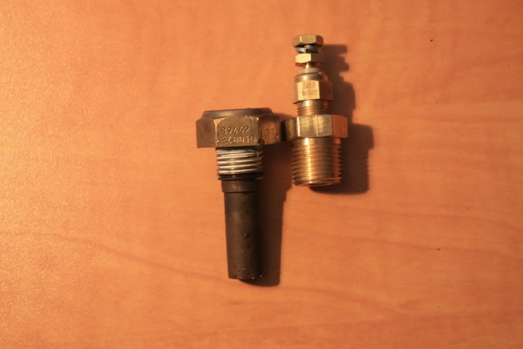

This is the difference in length of the sensors. Worried the new sensor won't be in the coolant and therefore won't get an accurate reading. Not sure if the area behind the thermostat is completely filled with coolant.

Put it this way. I ordered this part In 16mm x 1.5 and it went straight into the cold start injector time switch.
Don't know wh it won't work for you, but its working perfectly for me.
As for an accurate reading. The Thermostat will be open before you need to know exactly and accurately what the water temp is doing. Once it is open it will give you an accurate reading.

You could drill out the bottom of the adapter for the sensor, it could help with the flow around the sensor. The way it looks now it seems like the reading wouldn't be too accurate cuz the same coolant would be floating around in that little crevice... Know wat I mean?

see that flat spot right above the ecu temp sender? drill and tap that for what ever threads your aftermarket sender is for. Everything else stays hooked up as it should be and you get accurate temp readings.
Mine was 1/8npt. IIRC the tap cost >$5 at homedepot.

I think that's what I will do. I already have the tap and it will allow the sensor to be as far into the stream as possible. I guess I will remove the hose/neck and thermostat so that I can catch all the filings somehow. Thanks for the idea.
